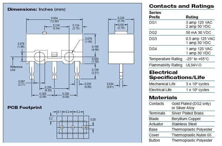

It will be electrically suitable but the question is whether it will physically fit correctly.
My guess is that it will fit but without a proper datasheet and the measurements of the original switch I really can't be sure.
