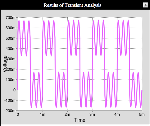

A circuit that combines two or more signals is called a mixer. In this lab, your goal is to build a mixer that combines the signals generated by two voltage sources, V1 and V2.
V1 is a 1 kHz square wave that varies between 0V and +1V.
V2 is a 5 kHz sine wave that varies between -1V and +1V.
Please design a circuit that mixes V1 and V2 to produce Voutput such that
Voutput ~=1/2V1 +1/6V2
The resulting output should be similar to that shown in Figure 1. The maximum value of the output is approximately 667mv and the minimum value is approximately -167mv
Figure 1. Desired output waveform
