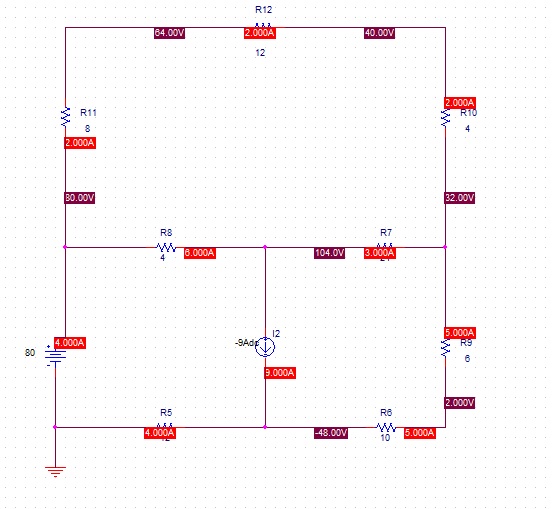

I seem to have forgotten some simple stuff here and its bugging me.
How do I figure out by looking at currents/voltage drops etc, which direction my current is going or rather how can I tell when a current source or voltage source is absorbing or generating power..?
i am sure this has to do with passive sign convention etc, but I am confused I guess. I am taking Electric Network Analysis for summer school and I just finished up the 2nd half of physics.
