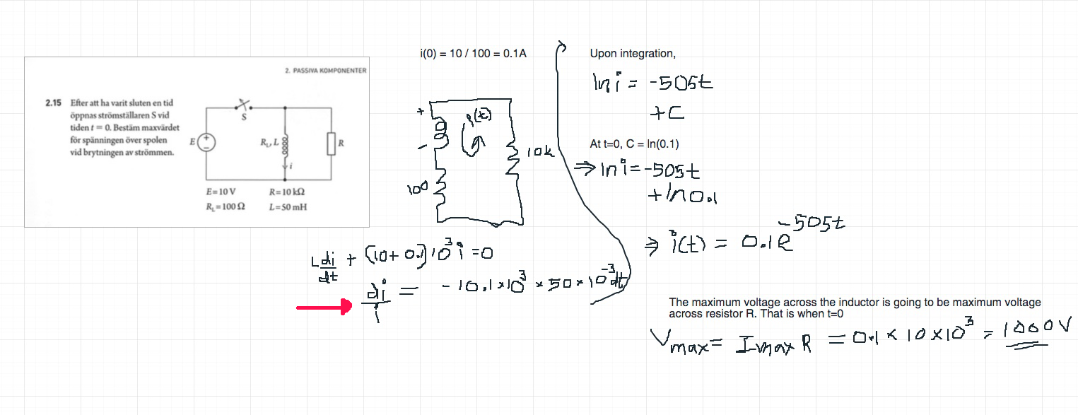

Translation:

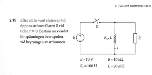

After being closed for a while the circuit opens at t = 0.
What is the max value for the voltage across the coil when the current cuts off.
I actually got a solution for this problem already seen here.
I don't understand what he's doing at this part:
di / i = -10.1*10^3 * (50*10^-3) * dt
So I guess 50*10^-3 comes from the value of L.
But why don't we divide the right side with L if we want to remove it from the left side of the equation ? (Here he multiplied the right side with L and it magically disappears from the left? what is this sorcery

Not sorcery, just really poor work combined with pure luck.
I certainly hope that whoever did this solution isn't the teacher or grader, because they have no business doing either, as far as I'm concerned.
Since I don't know what the students have seen at this point, I don't know if it was reasonable to set up the differential equation and solve it completely just to find the max voltage, which we know happens at t = 0 and which we can determine by inspection. The steady-state current before the switch opens is 10 V / 100 Ω which is 0.1 A. When the switch opens this same current must now flow through the 10 kΩ resistor, resulting in (0.1 A)·(10 kΩ) = 1 kV across it.
Notice that the size of the inductor has absolutely no impact on the max voltage across it when the switch opens. That's why the person doing the solution could be so sloppy and still get the right value.
But their complete answer is very wrong, and had they done either of the two things that I am always harping about they would have known it.
First, always, always, ALWAYS track the units through the work -- don't just tack the units that you would like the answer to have onto the end. Had they don't this they would have realized that they did something wrong because the units would not have worked out. Specifically, their time constant would not have had units of time.
Second, always, always, ALWAYS ask if the answer makes sense. The person doing the solution should know that the time constant of an L-R circuit is L/R, which in this case is 50 mH / 10.1 kΩ. This is going to be a number that is approximately 5 μs. Since this is in the denominator, the variable t is multiplied by the reciprocal of this, which is about 200,000 s^-1, and not 500.
Wow thank you, good explanation.
The guy who became up with this solution was a teacher on tutorme.com he got some money to help me with this. Still there are some very good teachers on that site but not everyone I realize now.
