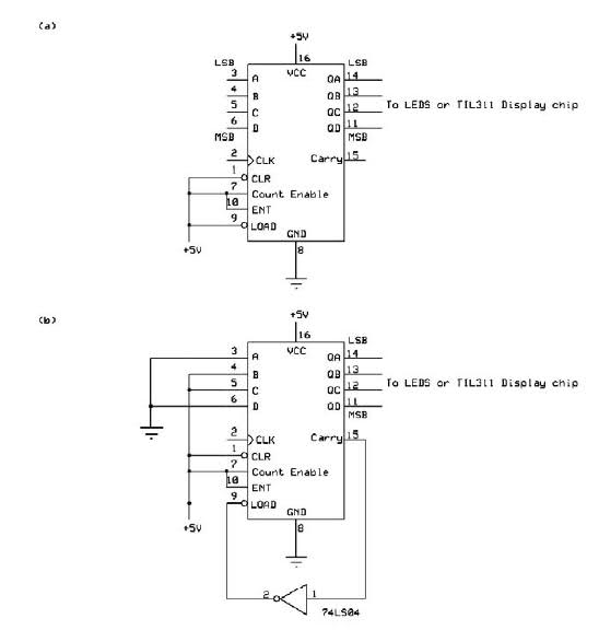

The problem: Design a counter using this chip which counts in base 10 rather than 16. The count should reset at 10, never displaying A on the output chip.
To be honest I'm a bit lost. I was thinking maybe I could maybe use the RESET pin on the chip, or reload it with 0 at the loading pin when the count hits a particular value. Am I on the right track? Please help this is due tomorrow ^.^
