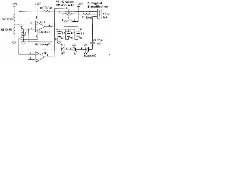

    I have some questions regarding Bob Beck's zapper as described in paper „Take back your health“. The circuit is as follows:
    http://i57.tinypic.com/30svq6v.jpg
    [​IMG]
    Circuit is based on lm358 chip which can act as square wave generator up to 1khz without voltage drop. I need chip that can act as square wave generator up to 100khz with minor voltage drop and two outputs being 180 degrees out of phase . Without going into further details I would like to clarify:
    1) output of lm358 - changes polarity with each cycle as it charges capacitor C1 through resistor R1 ?
    2) if so, do all op-ams which are set as square wave oscillator change polarity with each cycle ?
    3) if so, can two mono op-ams like lm318 be combined to achieve same effect as with lm358 ie. having two outputs being 180 degrees out of phase ?
    4) would two comparators like lm311 also be used in this way ?
    many tks

    1) It doesn't change polarity, since the 27V opamp supply is a single polarity: rather, it switches alternately above and below the mid-rail voltage (13.5V).
    2) If you had a dual polarity supply (say +9V, -9V) then the opamp output would change polarity.
    3) You could use two individual opamps instead of a dual.
    4) Comparators require pull-up resistors on their outputs and may not have enough current drive capability for this application.

    Comparators cannot normally source current, only sink it, so no.
    You need a 100kHz square wave generator. What voltage and current do you need?

    A couple of things. First, this circuit runs at approx. 4 Hz, like Beck's original relay circuit, not 1 KHz. Second, at 1 KHz with a 25 Vp-p output, there will be a noticeable slope to the output wavefore. In other words, it will be less square. This directly affects the number and amplitudes of the harmonics in the output wave.
    Yes, most opamps will function as a square wave oscillator in this circuit. And yes, two LM318's can replace the dual 358, but... The LM358 has a unique output stage that lets it swing very close to the negative supply pin. The LM318 is a more traditional opamp and will only get down to around Vee + 2V. So your output wave will be about 2V shorter.
    The LM311 is much faster than the 358, and has a similar output stage. An oscillator is shown on page 9 of the attached datasheet. But its output is open-collector, which would change the way the circuit behaves. The 311 is way faster than a 358, so at 1 KHz the output would be much more square. But at 100KHz it has speed problems. The graphs on page 4 indicate that the rise and fall times would combine for about 0.25 us, or 5% of each half-cycle at 100 KHz. Not very square.
    What is your final application for this circuit? Is it your intent for the 100KHz to be at 25Vp-p? That is a very different output in terms of its total power and harmonic content.

    Alec, this circuit replaces one that used a DPDT relay to reverse the polarity of the 27VDC. Note that the 2nd 358 stage is a simple inverter, and the circuit output is taken from the two 350 outputs (through a resistor for current limiting) so the effective p-p output is approx 50V, sorta.

    Yes I know beck used 4hz. What I am trying to do now is from another study to halt cancer melanoma. It says that melanoma cells can't replicate if placed between alternating electric field, strength 1v/cm and cca. 100 khz frequency as mitosis phase of cells fails.
    So what I am trying to do is put 2 light plates on someones chest and back to carry around and hook that up to electronic circuit that meets specification.
    Since plates are insulated from body I guess I don't need much current for E field, but getting this 100khz alternatic field is pain in the ass. I used 555 to get nice 100k but it is not alternating field. 318 and 311 as square generators also give nice results (I have oscilloscope) but problem with them is that they are mono and if they are placed in pair (either 318 or 311) output frequency of second chip doesn't match frequency of first chip so I guess signal is not inverted properly and I don't get proper alternating E field.
    Can I inverse 100khz output of 555/318/311 to get proper alternating electric field via 2 electrodes. It's quite and important research obviously and I will make sure to inform you about results :)

    How about this? It uses a CMOS oscillator rather than opamps. Q1 and Q2 act as level shifters. Gates are parallelled to increase current handling (but not really necessary). D1, D2 speed up discharge of transistor base capacitance. D3 gives a 5V supply for the IC. Output voltage is ~100kHz, 50V pk-pk for 100k Rload. Average current consumption is ~4mA. Rload current = 250uA for 100k Rload, 3mA for shorted Rload. Unused gates should have their inputs grounded.
