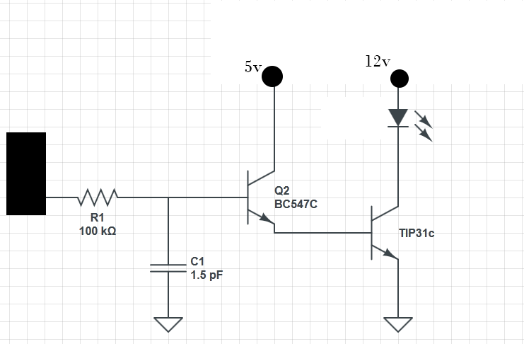

im building a small circuit with an ATmega32a to control a 1amp 12v LED with PWM. This is my current circuit:
Does it look ok? I added the capacitor from the BC547 base to ground since i was getting a little bit of voltage though the emitter when the micro-controller was off, making the LED slightly dim instead of off. Should I be doing that?
The circuit does work fine, just want to make sure it wont die soon or if there's a better way to do it.
Cheers
