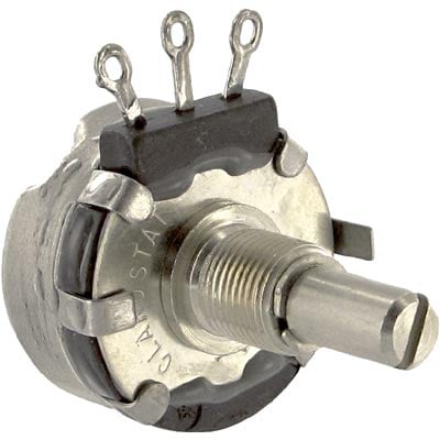

Potentiometers are known by various names, pot for short, variable resistor, voltage divider, rheostat, volume control, taper, fader, pad, trimmer, slider, etc.
Essentially, it is a fixed resistor with a wiper or slider that slides along the body of the resistor.
Diagrammatically, it looks like:
A pot is a three terminal device. The total resistance is the resistance from end to end, A to B as shown in the diagram above.
For example, if the pot is specified as a 10kΩ pot, then the total resistance from A to B is 10kΩ.
If you connect a 12V source across the A and B terminals, the current through the pot is I = V/R = 12V/10kΩ = 1.2mA.
There are three ways to calculate the power dissipated by the pot.
P = I x V
P = V x V / R
P = I x I x R
All three formulas will arrive at the same answer.
In this example, P = I x V = 1.2mA x 12V = 14.4mW
The pot would not even get warm.
Some folks may attempt to connect the pot as a variable resistor by using terminals A and W alone, or B and W alone.
This works fine so long as you do not turn the pot to its minimum setting.
Suppose you dial the pot from its maximum resistance of 10kΩ down to 10Ω. With a 12V source, you have increased the current from 1.2mA to 1.2A!!!
Potentially, that is equivalent to 14W. At that point you will smoke the pot, burn out the resistance track at that end of the pot, in effect destroying the pot.
Bottom line
Limit the maximum current the pot will ever have to conduct for all positions of the dial.
Are you ready for the next lesson on how to create a current regulator for your EL lighting?

If your circuit is wired correctly the pot should not get hot. The highest current flowing from the top terminal of the pot to the wiper is 12mA.
How much current does the driver take at full 12V?
Alec_t
Joined Sep 17, 2013
15,119
The only way I can see your pot getting hot is if you have mis-wired it like this :-
Double-check the wiring. The centre pin of the three on a pot is usually the wiper, but you can't guarantee it.
