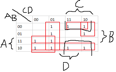

    From the truth table the minterms is Ʃm(1,2,3,5,6,8,9,10,11,12,13)
    So I came up with this K-map, not to sure if I'm correct. I've read Chapter 4 for Karnaugh mapping from the website and my textbook but I'm still confused.
    [​IMG]
    Not sure if I'm missing another square that would consist of (1011,1010,0011,0010) but other then that I've simplified it to
    A'B'C + AB'D' + C'D + AC' + AB'
    Any help would be greatly appreciated, thanks :)

    You have a number of mistakes.
    You must label your A, B, C, D.
    Three of your terms don't make sense.
    You have omitted minterm 6.
    You do not need the two cells grouped in blue. This is already included in the bottom four.
    The four cells on the right side can be grouped into one term.

    Still not quite right.
    There are four groups of four terms and one of two terms. This should be reflected in your answer.
    A'C'D' and A'B'C don't make sense.

    Map is right, I have something different:
    A'CD'+C'D+B'C+AC'
    Mapped to your original function, the terms, function output, parts of Kmap [ABCD] for each term, location.
    13 is redundant, I might not have done this right, either.
    A'CD' -> 2,6 -> [01|00]10 (upper right corner)
    C'D -> 1,5,9,13 -> xx01 (second column)
    B'C -> 2,3,10,11 -> [00|10][11|10] (box that wraps from bottom right to top right, 2 bits wide)
    AC' -> 8,9,12,13 -> [11|10][10|01] (lower left corner)

    This is correct. But it does have two static-1 timing hazards that can be eliminated by including the consensus term B'D (which is what MrChips was referring to about redundancies eliminating glitches).
    There are so many 1's in this table that it might be easier to deal with the 0's.
