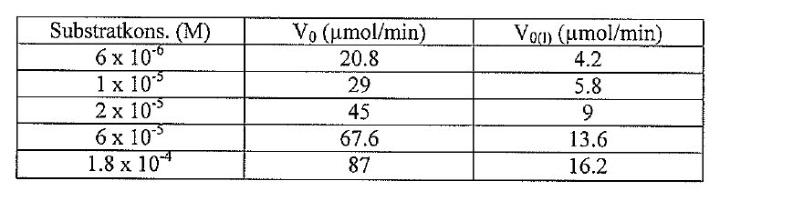

I'm asked to calculate V[sub]max[/sub] and K[sub]M[/sub] from this, with and without the inhibior, and answer what kind of inhibitor it is.
I have plotted 1/
The x-intercept is -1/K[sub]M[/sub]. The value I get is -1/K[sub]M[/sub]=-4E4, so that K[sub]M[/sub]=25E-6. Does this mean that K[sub]M[/sub]=25E-6 M? My book says 20-24 M. Of course, I might have been unaccurate in drawing the graph, but why do I miss by a factor of 1E6?
