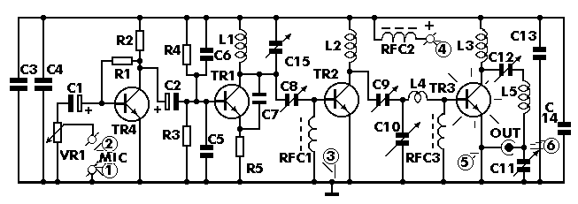

see attachment for my FM transmitter.
It works weird.
When my transmitter is close to my regen receiver and my commercial radio, it floods part of a station. I'm afraid to change the transmitter frequency because some frequencies cause interference to my moms TV.
When I'm about say 15 meters away from the transmitter, I seem to pick up the signal at two frequency points on my superregen. It seems that as I begin my tuning, the 108Mhz station (Y108 in hamilton) comes in first, then as that fades, my music that I transmit comes in nicely, then I get silence, then I get my music again, and then finally white noise.
When I am farther away (about 250 or so feet), I can pick it up if I hit the frequency dead-on and the receiver is in the correct position.
Is there any way that I can increase the range of my transmitter, and maintain the quality of the sound without increasing the voltage or changing the transmitting frequency?
