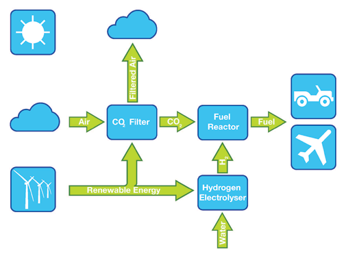

Thanks for the link. :)
From their technology page;
http://airfuelsynthesis.com/technology.html
It looks like they are using renewable energy and standard electrolysis to make H2, then renewable energy to extract the CO2 from air, then another process (that does not consume energy?) to convert H2 + CO2 into a hydrocarbon fuel.
Are there any chemists here who could discuss that? And if the principles could be adapted to a low cost home setup?
