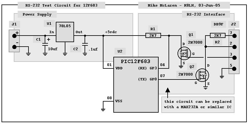

BeeBop
Joined Apr 25, 2006
17
OK. Thank you very much. Now, so, it seems that one communiation method between a microcontroller and a PC or the like is via RS-232 protocol, the max232 is a little connector that sits between a microcontroller and a PC and their communication is faciliated via a piece of software (easier to reside inside PC). Yes? Technically.
The max232 is a converter chip. It converts TTL levels of 0 to 5v to rs232 levels of ~-12 to 12v. There are different versions of the max chip, which require different capacitors. The cheap 232 chip use large electolytics, while the more expensive ones use mono 104 caps. There is also a max233 chip which needs no external caps, but that costs more.
You can also do this with a pair of FETs. See this here:
http://www.electro-tech-online.com/attachments/micro-controllers/7923-rs-232-pic-stepper-motor-interface-rs232-circuit-12f683.jpg?d=1146858636
Here is a link to the thread which talks about it:
http://www.electro-tech-online.com/micro-controllers/21267-rs-232-pic-stepper-motor-interface.html?highlight=2n7000+rs232
The connector is a DB9, and THAT goes between your max232 and the PC.
The software on the PC side is Hypertem, or you could write your own with VB, or ...
You will also have to set up a software UART on your PIC, to communicate.
