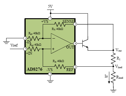

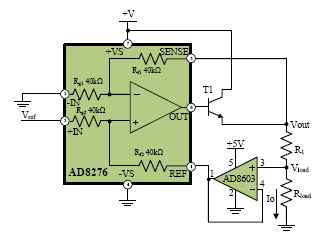

Hi guys, I'm trying to tackle a precision current source design. This is an application note i found from AD. The one shown above is a simplified version of this:
And the I(output) =
http://www.analog.com/library/analogDialogue/archives/43-09/current_source.html
I'm just trying to start with the simpler one I showed up top but can't even get past that. Could anyone enlighten me on that?
