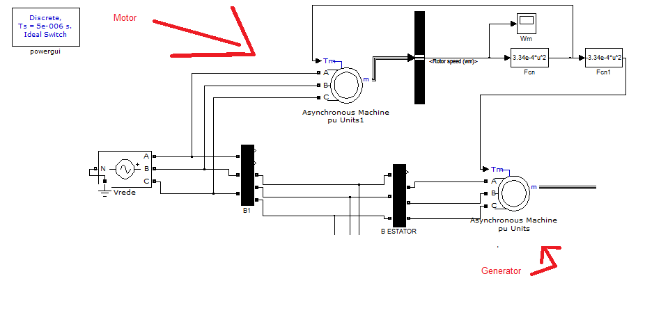

Hi,
I want built a system on simulink where I've an a assynchronous motor with squirrel cage rotor driving an a assynchronous generator to test if my the control system of the generator is working. So my system is something like the image bellow. My problem is that I dont know if the block corresponding to the motor is really working like a motor and not like a generator. And the same doubt applies to the generator block.
I read on simulink help that when Tm is <0 the block works like a generator and when it's positive works like a motor so I've used two fcn blocks to give different signals to the two machines. Can this be done this way? How can I confirm how the two machines blocks are operating? The conection to grid of the two machines (Vn=220V, fn=60Hz) makes sense?
