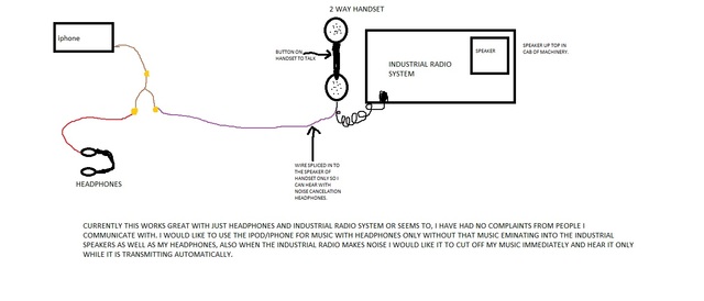

Hello there, let me see if I understand this. Your radio has a speaker and a handset. So...when someone radios you, it breaks squelch, you hear the speaker.....you pick up handset, it mutes the speaker and you get audio thru the handset. Is that correct? Next...you have an iphone and the iphone headset. You have the iphone headset on so you don't miss a call. But then you can't hear the radio break squelch. Right? No. No. That can't be right...........you'r watching a movie and you can't hear the radio, RIGHT? I knew it. I knew it. Ha. Ha. Ha. "I have all this connected together with heaphone adapters and jacks." Exactly what does that mean? I understand what you want to do. I need to understand what you have done. Be very specific. Tell me each connection you have made and how you change them when you switch. I am assuming you are talking about RX audio and NOT the mic audio. I am assuming the radio is a base unit. Have I got this right?
