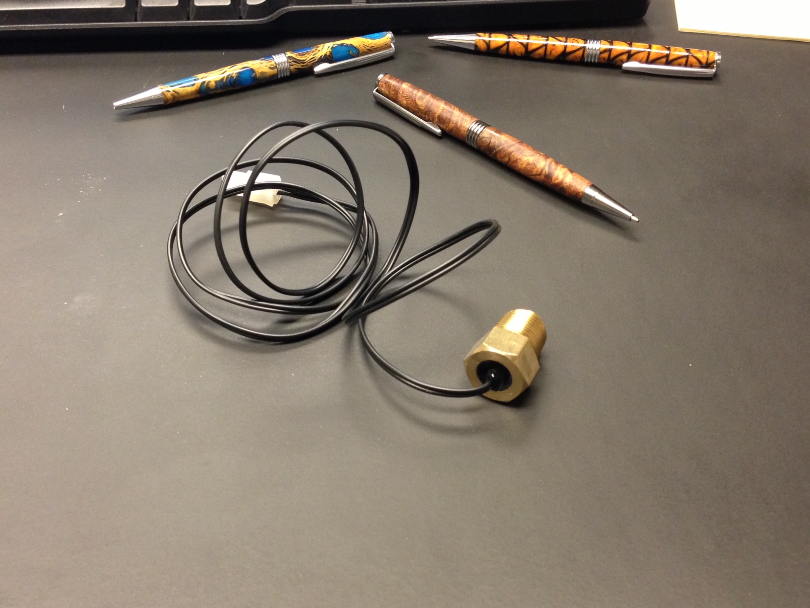

    Below is an example of how the finished product should turn out.
    [​IMG]

    I guess I messed the picture up. Here is another try.
    [​IMG]

    This looks like the small wires of the thermistor get butt spliced to some substantial stranded wire. I might be thinking along the lines of a crimp/solder ferrule like this or this.
    A ferrule slipped over the thermistor lead would guide the stranded wire in and hold the wires together while soldering. If you get a crimper $$$ would provide a good mechanical connection as well.
    Other than that it might be twist, solder and shrink. You'd get tired of your wife being tired of doing that..
    Perhaps others know of a better way..
