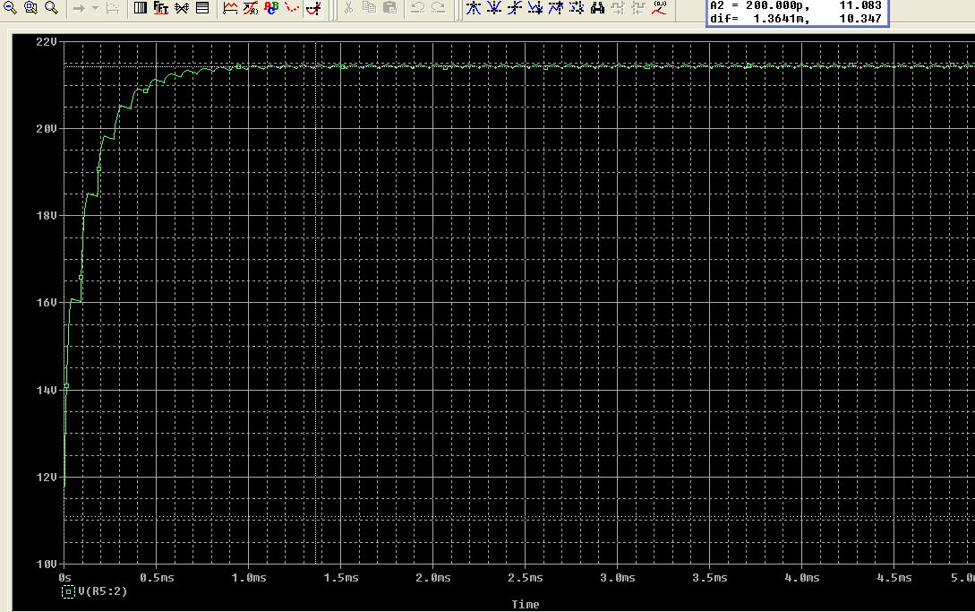

This is an example of a charge pump doubler I have running off a PIC I built it for a HS driver. The PIC is outputting about 10kHz 50% duty for the charge pump.
The resistor R5 represents the load in my case the driver current. The pulse source V1 is your processors output. PIC’S can only run off 5V so I’m using the extra BJTS to start at an initial 12 volts and double it rather then triple it off the PIC. This has been modified from the original application for a quick example for you so if someone sees errors chime in. You could use shottkys for smaller losses.
The output voltage almost doubled.

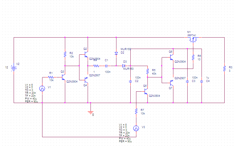

Here is a discrete High side driver. I didn’t waste time calculating resistor values or selecting the best FET but it should give you an idea on how you could do what you want. It should give the ability to pulse the fet,or keep it open or closed for extended periods. The pulsed sources are your processors outputs.

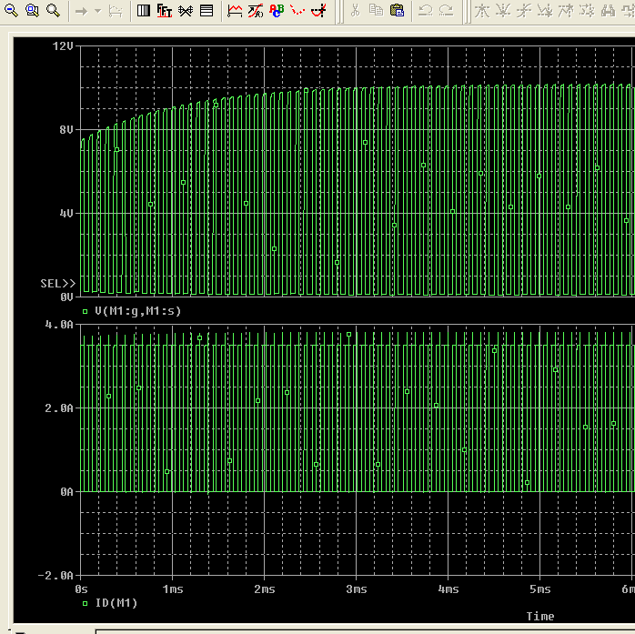

Here is the output
Top trace is the fet gate source voltage. Bottom trace is the drain current. Pulsed at about 10kHz 50% duty.
You could also use the charge pump to supply Vcc for a fet driver like a low side fet driver rated for at least 25 volts Vcc.
But the above should work. You have to go through it and tune resistor and capacitors so it’s optimized. You want it to pump up the voltage as quickly as possible, so the fet isn’t stressed. You could in software provide sufficient delay for the Caps to charge up before you start switching the Fet for example. Also don’t use the IRF741. I just used it for the sim you should use a logic level FET for at least 30Vds to 60 Vds area with about 10A or better continuous rating, with minimum gate charge (Qt). Its a bit of a balanceing act you dont want to dissapate to much power in your charge pump and drive circuit. But you want quick transtions on your fet.
