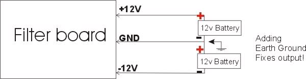

Once the filter/amp board is connected to laboratory (earth grounded) power supply - everything works fine. However, it is supposed to be powered by two 12Volt batteries and be a mobile system, then when it is connected to two 12V batteries filter board's output becomes noisy and drops down significantly. What happens next is very puzzling for me: When I connect "Common ground" between batteries to "Earth ground" from 110VAC wall plug, everything becomes normal.
Can I somehow improve my filter output without connecting it to wall earth ground??? It has to be a mobile solution.

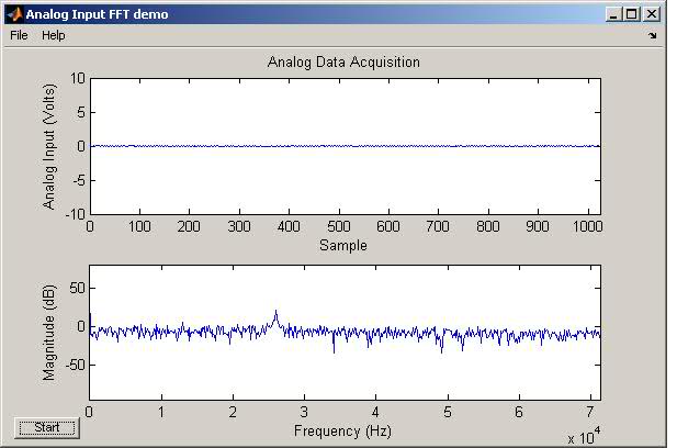

Here's AC-ground output:

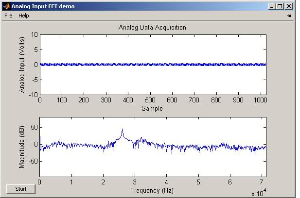

Here's "wrong" battery-ground output:

Connect the chassis ground of the computer to the "virtual ground" between the two 12v batteries using a good-sized conductor.
It's likely that you have a ground path from the computer through the filter board and then eventually to the virtual ground between the batteries. This will cause a great deal of noise.
Good point, tried that. Made absolutely no difference.

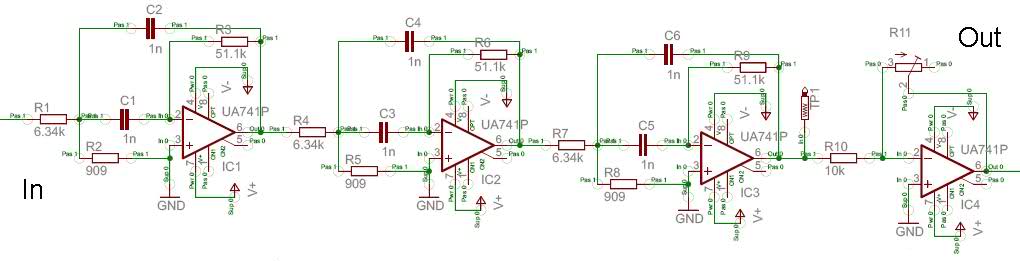

It strikes me as your signal source could have some significance. Could you post the complete schematics?
Absolutely, here's complete schematics for a single channel:
Not sure what you input/output , gain and gain margin levels are like for your filter, but is it up to the job?
The input signal range is 20mV peak to peak, I'm amplifying it to 1V peak to peak which roughly gives us Gain=50; However, I must mention that I'm varying gain through a simple potentiometer.

John, you made many good points, and indeed our laboratory power supply had some noise on its ground at 50Hz that we attributed to normal AC noise, however it does not really interfere with our circuit.
My issue is battery power which has no measurable noise whatsoever (Tektronics 350Mhz Scope).
Thanks for a very good article.

Have you measured the power supply noise at the op-amps?
Also I do not see any decoupling caps on any of the op-amps.
The ADI article gives hints on how to decouple a variety of op-amps.
