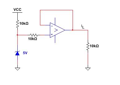

Hi, I was hoping someone could help me with the following circuit. Does anyone know what this circuit is? I need to calculate the output current.
Low voltage regulator??

The opamp is connected as a follower so its output voltage is exactly the same as its input voltage.
Do you agree that its input voltage is +5V?
Then use Ohm's Law to calculate the output current.
Simple.

When the output is fed back into the negative terminal like that, it is called a unity gain buffer amplifier, or just buffer amplifier. So the voltage at the (+) terminal is the same as the output voltage.
Not sure how your class treats LED's, but mine treated them like a voltage source. The flat side of the triangle is the positive end of the LED, and the pointed side of the triangle is negative, so the voltage in the (+) terminal of the op amp is -5 Volts (remember, the voltage across the 10k resistor connected to the (+) terminal is 0 because almost no current flows into the op amp terminals).
So the output voltage is also -5 volts since the (+) terminal voltage of a buffer amplifier is the same as its output voltage. And then you just use ohm's law to find the current.

I see no LED here. :rolleyes: There is a reverse biased zener diode though.
