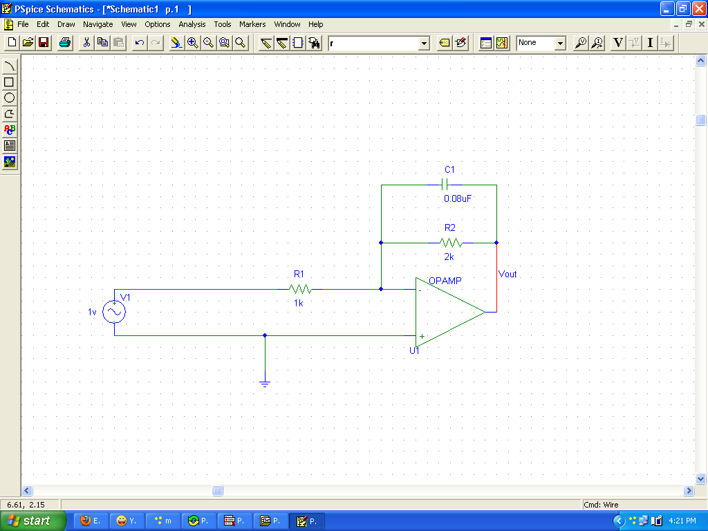

    Hi everyone i got project from someone
    Here is the Project
    Code ( (Unknown Language)):
    1. www.stanford.edu/class/ee122/Spice_Decks/pspicedemo.pdf
    And i did the same what the pdf file tells
    Here yall can see the video which i made
    1. http://rapidshare.com/files/390247187/CaptureWiz005.wmv
    Or
    1. http://www.youtube.com/watch?v=4G82E2uDP2A
    But rapidhsare one's quality is good
    Circuit Pic
    [​IMG]
    [​IMG]

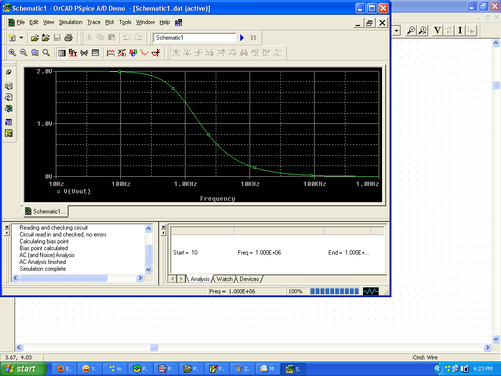

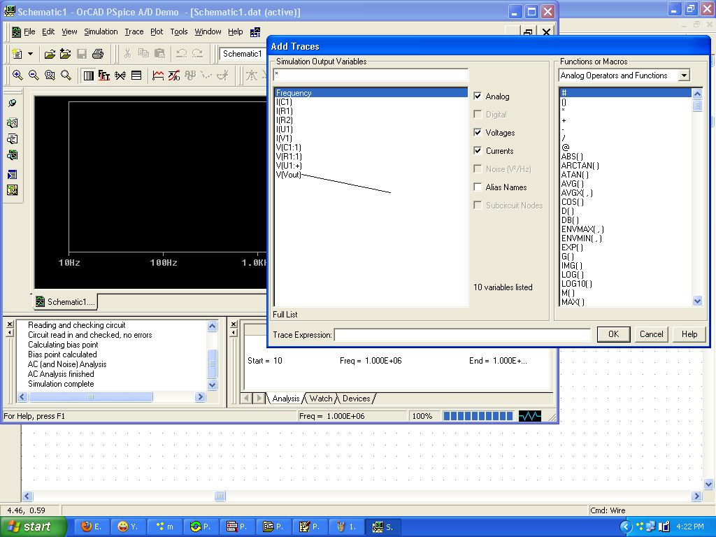

    The graph which i want to invert
    [​IMG]
    Can someone help me with inverting the graph?
    What should i add in the circuit to invert the graph?
  2. Jony130
    AAC Fanatic!
    Feb 17, 2009
    4,082
    1,149
    OMG
    Spice AC analysis don't show "minus" sing.
    You must use phase marker or transient analysis to see that signal is invert.

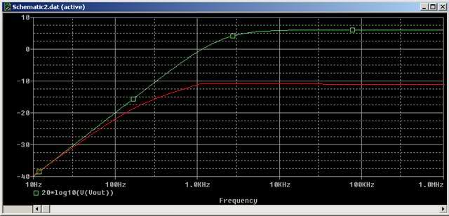

  6. JoeJester
    AAC Fanatic!
    Apr 26, 2005
    3,511
    1,348
    From my understanding, they want to invert the sweep ... something like the attached.
    I applaud his efforts in helping his friend.

  7. sheheryar_noor
    Thread Starter Member
    May 22, 2010
    32
    0
    Look at this Pic it is a graph of Vout
    It moves from 2.0V to 1.0MHZ means from top to bottom
    And i want it to move it from down to top
    Here the pic is
    [​IMG]
  8. JoeJester
    AAC Fanatic!
    Apr 26, 2005
    3,511
    1,348
    What did the instructor say for this assignment .... you never answered that question.
    I imagine this is what you want ....
      File size:
      17.1 KB
      Views:
      24

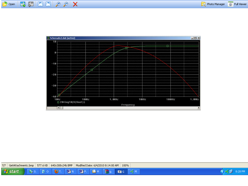

  11. sheheryar_noor
    May 22, 2010
    32
    0
    Joe thanks 4 keep replying
    i was in the hospital with him
    His friends just draw red lines on ur screenshots to give me a clue
    Look at these red lines i want graph like these red lines
    [​IMG]
    [​IMG]
    And i hope that guessing game is over
    Is it enough or i should get something more to make u understand?
    Thanks again
    Let me know if u can make like these Ok
  12. JoeJester
    AAC Fanatic!
    Apr 26, 2005
    3,511
    1,348
    The problem is the original circuit is a low pass filter. You originally stated you wanted it inverted, which could mean the objective was to make it a high pass filter (my last graph).
    So far, you've gotten opinions from your friend and his friends ... yet not one word from what the professor stated or a hint and what the professor was seeking with the exercise.
    In your first picture ... the student had a lower output high pass filter than I did. That may be well and good, but losing 10 dB might not be what the professor had in mind.
    In your second picture, the student had a bandpass (cutting off both the low frequencies and high frequencies) filter. Again, this may not be what the professor had in mind and it does not fit your description of inverted.
    You are a good friend to take on this tasking. Why can't you approach the professor and see what they wanted?
