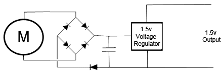

Hi everyone!
I am new to electronics and have been learning the basics. I am trying to make a power harvesting device that generates power from the kinetic energy of a person while they are moving. The kinetic energy of the person drives a small motor generator, the generated power gets stored in a capacitor and is used to power a lower power electric device (around 1.5v, 20ma).
Is the circuit I have designed below workable?
The DC motor will output between 0 and 4.5v depending on the speed the person moves. The DC motor can turn both clockwise and anti-clockwise so there is a rectifier bridge. And there is a blocking diode to prevent the current flowing back to the motor from the capacitor. The linear voltage regular ensures a 1.5v output.
I expect that the small motor generator will produce very small amounts of power and my concern is that the rectifier bridge and blocking diodes will cause a significantly voltage drop even when using Schottky diodes and there will be further losses from the linear voltage regulator. Can anyone suggest if there might be a better way to do this to allow the best chance of working?

What you have will not work well. Since you have about a voltage drop of 2.1 V across the diodes, and you need at least 1.8 V for the regulator, you will not see a controlled output until the generator develops about 4 V. You will probably see some output between 3 and 4 V, but it will not have a 1.5 V regulated output.
Since the bridge diodes are configured the same way as your blocking diode, get rid of it. Now it is down to about 3.3 V.

Surprised no one so far has mentioned that as the OP said "And there is a blocking diode to prevent the current flowing back to the motor from the capacitor." The diode is backward, it allows the flow back to the motor.

Thanks for the information guys, it's really helpful!
I don't know what I was thinking when I added the blocking diode, as you all mentioned it's completely unnecessary.

As noted, at low voltage you are battling with the relatively large power loss you will suffer in the rectifier. Losing 1.2V across a rectifier is bad enough in a 12V system - where rectifier losses are 10% of the useful power produced. If you're only getting ~1.5V of useful voltage, the rectifier is losing almost half of all the power you are capturing.
Consider using mechanical means to: 1) keep the polarity the same, so that one diode - half the loss - could be eliminated, and 2) increase the motor speed to produce a higher voltage output. These changes don't increase the available power, but they do help send more of it into a useful load.
An active rectifier (I'm guessing the Micrel chip is such a thing) can eliminate the diode drop but needs a voltage (but almost zero current or power) to control the gate of the internal MOSFET.
