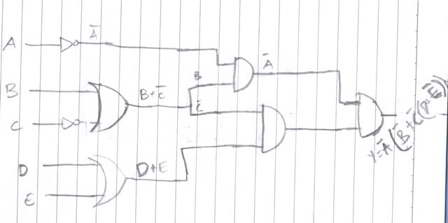

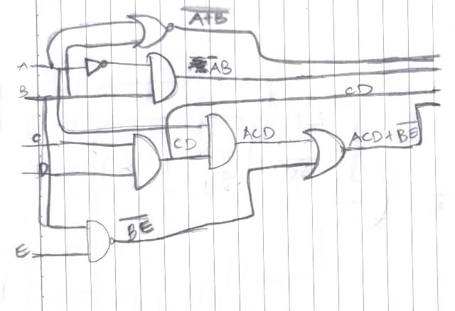

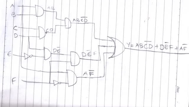

Did you miss a class? Again, we don't do your homework, but we will help you learn. What part of drawing them are you having problem with? Boolean multiplication is an AND function, + is an OR function, and the ' is inverted.
I will give you an example off an old illustration I made a while back.
The formula for this problem is
or X = A'B'D'+BC'D+AB'CD+A'B'C'
Note the AND gate correspond to the multiplication on the Boolean equation.
One of the ways you convert gates to other gates with equivalent functions is:
I've only done one, and that is all I plan on doing. I have a feeling the OP missed a critical class somewhere. Having made the effort I'll try to show how it needs done in such a way he can pick it up.
