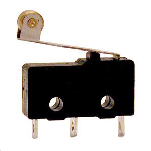

    I'm making a machine with a moving gantry (like a clossic cnc machine). The bridge has to stop when moving from the left to the right and can go on without stopping when it goes from right to left.
    Indeed these are push switches and not slide switches.
    Something like this

    Actually, the switch image that you posted isn't a push button switch. It's generically called a 'Micro-Switch'. When used in an application like yours they're called 'Limit Switches' that describe their function.
