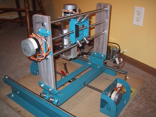

these are what would be suitable for CNC drives, I have seen people use coarse threaded 1/4-20 rod for the screw drives.... I used the 3/8" -12 ACME Rod (3/8" diameter, 12 turns per inch) >> http://www.mcmaster.com/#acme-threaded-rods-and-studs/=5v547f General purpose should work fine, you can always use a smaller diameter for your needs.....
You can also use brass bushings as the rod end guides, less expensive than flange bearings...
Bearings are another thing, on my setup I used 8 bearings per axis....
each bearing would have cost around $40.00 dollars a piece :eek:, I got lucky and got 16 matching ones at the local scrap yard for $5 dollars (basically the price for scrap weight :rolleyes:).
So the electonics are not really the costly part, it is the hardware for making a stable machine for doing some fine work is what is going to cost you, with the setup I Have I get around 2400 steps per inch (1.8 degree steps in a 360 degree rotation = 200 steps * 12 turns per inch = 2400 incremental steps per inch) so it is pretty accurate down to a couple thousandths of an inch!:D

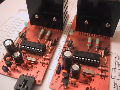

Salvaging Steppers from old office equipment such as printers and or plotters are a good source for steppers, Home use scanners and printers (dot matrix ones anyway, most deskjets and inkjets use dc motors with encoders) also have some steppers but are usually too small for any milling / engraving applications. And the stepper control IC's can also be salvaged along with most of the passive components for its circuit, since most of these old plotters/Office printers used through hole components....
Here are 2 complete Bipolar stepper motor controller boards I just recently built from salvaged components, the only thing not salvaged is the PIC16F84A and its passive components (Such as the crystal, etc.)....
and here are the Salvaged Steppers I am using with them..... the belt drives and pulleys were also salvaged from other equipment.....
Some equipment such as pen plotters / Vinyl Cutters can be easily converted to a CNC Mill.Engraver without hardly any modification to the hardware or drive circuits, and can be used as is.....

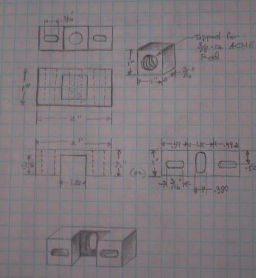

There is plenty of clearance for the nuts used for the screw drive, for the 3/8" diameter ACME screw I am using the nut is only 1" x 1" x 3/4"....
Here is a sketch of the Offset compensating nut I designed, since you are not guaranteed a straight threaded rod, there will always be some curve or offset to it no matter how small of an offset, it could jam your machine or stall it, so I designed this to compensate for that....
here it is after I made it, I made 2 of these, 1 for the X axis, and 1 for the Y axis, for the Z axis I used a brass nut....
Here it is in place on the Y axis....
and these are not that big to where they take up a lot of space either since my table capacity is only (Y)12"x(X)16"x(Z Depth)4" ..
And yes, they can be made out of other material such as Nylon or even that cutting board material, just make sure it has low friction and good ability to resist wear....
I have also seen some people would take 2 of the nuts and tighten them against each other to compensate for the play, this seems to work for some with the off the shelf screw lead nuts.
I have also seen people use the coarse thread rod such as the 1/4-20 ANSI threaded rod which is only about 1/4" in diameter (20 turns per inch) and can flex too easily, also the threads are coarse and not machined so it would wear out the threads in the nut assembly pretty quickly, that is why I went with the ACME rod, since the threads are made for surface to surface gliding, so they are pretty smooth which will reduce wear on the nut threads.....
You can find all kinds of ways to fabricate your own or modifying an existing one at the CNC forum....
Mach3 Software also has the capability to compensate for backlash, so if you do end up with some play on the drive screws, you can compensate for it in software.... that option was not good enough for me so I opted to design my own lead screw nuts....
