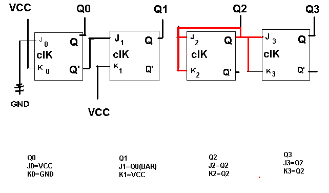

i have this problem in my science class we are going to put this
design a 4 bit even counter design using jk flip-flop
(0,2,4,6,8,0 so on..)
the state are
0-0000
2-0010
4-0100
6-0110
8-1000
next state
2-0010
4-0100
6-0110
8-1000
0-0000
this is what i got from my k-map
Q0
Jo= 0 Ko=1 LSB
Q1
J1=Q0(bar) K1=1
Q2
J2=Q2 K2=Q2
Q3
J3=Q2 K3=1 MSB
i tried putting this on my breadboard but the output isn't right.
0110
0111
it keeps repeating on that sequence
I did something wrong but i don't know what it is i'm just 12.
can you tell me?
