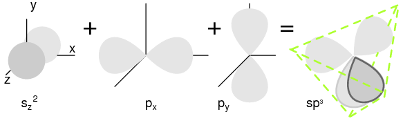

    The tutorial found on Valence and crystal structure
    You say that the hybridization for tetrahedral is s^2p^2
    This is incorrect the hybridization is sp^3
    Additionally, the following image is incorrect:
    [​IMG]
    Though it does get the final hybridization right, it is missing the P_z orbital and the s orbital is incorrect. There is no dimensionallity to s. It is always a sphere centered at the origin.

    A more proper hybridization image (albeit it leaves out the antibonding orbirals but those are not really relevant here):

    I believe you are correct so far as you go into the bonding orbitals of atoms. Frankly, I was surprised to see the s orbitals shown that way. My guess is that it resulted from a typo. Sz was probably intended to be pz, and the s just got lost. John
