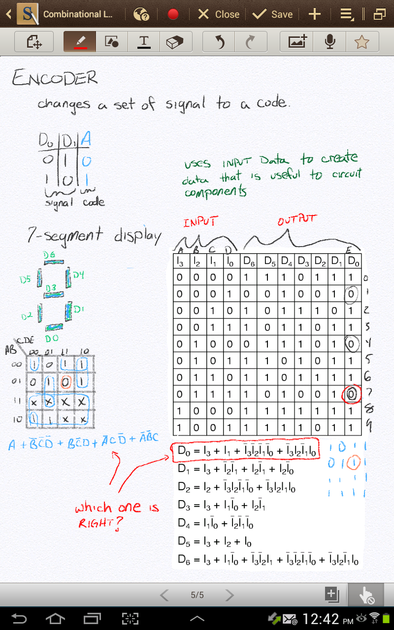

Without going too much in depth at the moment, the labels on your seven segment display is different, so coming up with a different result is expected. Whether or not yours is correct is another thing...
Georacer
Joined Nov 25, 2009
5,182
You seem to have a point.
On the Boolean function for D0, there is the I1 term which forces row 7 to be 1, instead of the desired 0.
I 'd like another one to confirm this before mounting it in the corrections list.
tshuck
Joined Oct 18, 2012
3,534
yeah, just look at the row for 4. I'm not sure what character would be displayed, but it certainly wouldn't be 4... and the 3 is backwards...
Georacer
Joined Nov 25, 2009
5,182
I found another culprit. The numbering of the segments in the e-book is wrong. Your D0 is at the bottom of the figure, whereas in the e-book it's on the top.
Schoen, based on the truth table, your notation is correct.
But on top of that, there is the error of the Boolean function extraction that you pointed out.
We need to re-calculate the Boolean functions.
Schoen85
Joined Jul 30, 2013
3
I noticed from a previous page that if you rearrange the 7 Seg display so that D0 is on bottom and D6 is on top then the truth table is correct. But if the table is correct the simplification isn't.
Dcrunkilton
Joined Jul 31, 2004
422
I find if I re-arrange the LED figure, the table matches.
------6------
5 .........4
------3------
2..........1
------0------
However, as you point out, the equations, logic diagram, and PLC diagram don't match.
This should keep me busy for a day or two.
And, Schoen85 gets the prize for the all-time worst error I have ever seen since Tony Kuphaldt passed the baton. How many years has that been. Meaning there is no way possible to blame him for this one. This one was entered on my watch. Once I get the corrections entered I will need you guys to review it in detail. That is how extensive the re-work will be.
