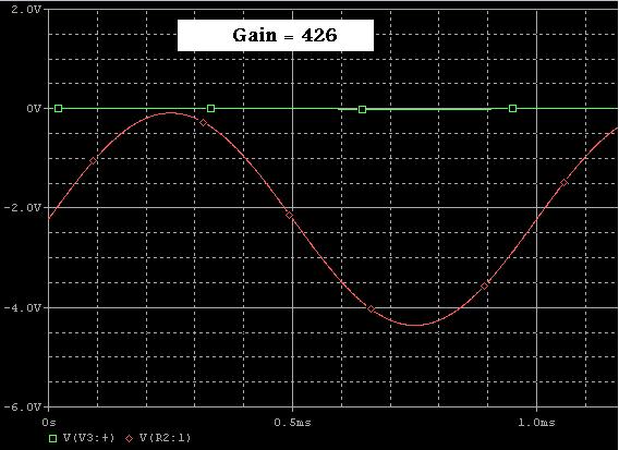

I`ve designed a differential ampli with two pnp transistors
those are bc807-40 .I had never worked with a pnp tran before.
the question is getting the most possibe gain from the circuit.
as you see in te pictures I have connected a current mirror as
a current source under the tho emitters.
I have two Rc with the value of 21 k.and because my current mirror is giving me
1.221 mili Am those Rc were the highest I could put there not allowing
the transistors to go to saturation.
Was my design correct or you see problems in that?
do you have any Idea to make the gain higher?
the schematic of my circuit is below:
I look forward to your guidance.

I think hgmgr's point was that you can't use an NPN current source. You have created a monster whose differential pair is accidentally biased in the active region. See the annotated schematic below.
You need a PNP current source, as hgmjr pointed out.

YEAH AS YOU SAID MY FIRST circuit was really accidentally giving me
the current needed. my npn was in saturation that is not accepted
in a current source.
I changed it to a pnp one but the design that hgjmr gave me for current
source was giving me only pico ampers. so I changed it like this.
I put the 15v dc source behind the emitter to bias my current source.
Now I am giving 2 mA whicht I needed .thanks to both of you.
here is the new scheme . the two upper transistors does not seem to be on
saturation but my Vout is cutted (up & down). whatever I PUT in Rc place
did not effect what do you advise me to do right now.
boby4u
Joined Jun 1, 2007
26
If I bring the V(in) lower to 0.1v then Vo is not cut.

By the term "cutted" I assume you mean "clipped" at the top and bottom of the waveform.
That is most often a sign that you have more gain than you need for the signal level being applied at the input.
I also notice that you are now using a dual supply scheme with +15V and -15V. That should give you the potential for a greater output voltage swing. Your very first schematic only had a single 15V supply I believe.
Since your input signal is DC coupled and referenced to ground, the signal swing on the collectors is going to be limited in how far it can go in the negative direction to around +0.7 volts due to saturation. I think this is what you have already observed.
If you can ac couple your input signal then you could bias you differential transistor pair to a more positive voltage so that you could take greater advantage of the available power supply range.
