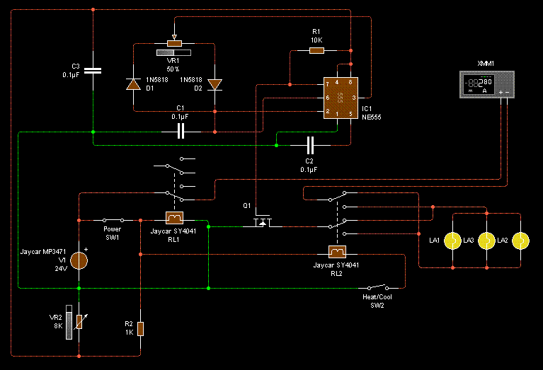

    So the following works ok in the simulator:
    [​IMG]
    (thanks to http://www.dprg.org/tutorials/2005-11a/index.html for the PWM 555 circuit).
    So the problem now is that the current draw is down from 5A to 2.8A max, giving a max of about 65W. Probably not a bad thing, but is this just due to inefficiency in the MOSFET? I noticed that changing the voltage to the 555 changes the current through the MOSFET; so I assume that proper MOSFET choice will be a big issue?

    An NE555 has a maximum Vcc of 16v. I suggest 12v is a good Vcc for your application.
    An N-ch power MOSFET generally requires Vgs=0 to turn it off, and Vgs=10 to turn it fully ON. You will need to check the particular MOSFET you use for it's particular specifications. An IRFZ34 or IRFZ44 would likely work well for this application.

    Thanks folks, I'll check these suggestions out and let you know how I get on. I am thinking too I should add some diodes around the relay coils?

    Shouldn't the temperature of whatever the Peltier device is heating or cooling be the controlling factor?
    Why not regulate the output with a thermostat controlling a soft-start circuit to bring the power on gently over a second or two and then off when the target temperature is achieved? The soft-start may prolong the life of the device by avoiding thermal shock associated with on/off cycling.
    Just another thought, 2 SPDT relays could be used to do the same job of switching power and polarity reversal.
