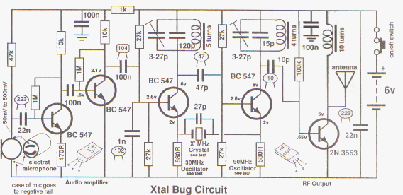

I've built a few FM transmitter kits - always with a coil. I've found that these kits always drift in terms of frequency.
I've seen a few circuits online for crystal-locked FM transmitters but a lot of them use crystals that are very hard for me to find in the country where I live, and in terms of cost it's hard to justify the cost of importing a crystal from overseas.
Some circuits state you can run a 10 MHz crystal (which I can source over here) in its "third overtone mode" to reach a frequency of 90 MHz.
This is the one circuit I found:
http://www.talkingelectronics.com/projects/CrystalLockedBug/CrystalLockedBug-1.html
Circuit:
People seem very familiar with the talkingelectronics website - I was wondering if anyone has built this circuit?
