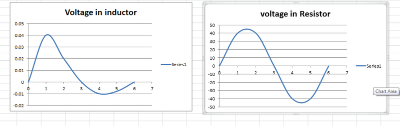

Hi i got this question ?
have to find Vr and VL
so can i use this formula :
VR = IR
VL = I * XL???
confuse ?? need help ??

No, both are wrong. You need to check it again.
VR = I* R and because R is constant VR and IR has the same shape.
UL = Ldi/dt and you need to consider i in each time periods.
yeah i know voltage in resistor doesn't go above 40 and -40 but i dont get it with the inductor ?

The voltage in the resistor does not exceed +40V or -40V.
Units matter.
You've already found that, between t=0s and t=1ms, that the voltage across (not "in", you also need to start using the proper terminology to minimize miscommunication) the inductor was 40V. So why does your graph show it changing in this time period?
What is the voltage across an inductor if the current isn't changing?
Is the current changing in the inductor in the time periods 1ms<t<2ms or 4ms<t<5ms?
What is the voltage across the inductor during these time periods?
Is this consistent with your chart?
You need to not only start tracking and checking your units, but you need to start always asking if your answer makes sense. Do those to things, relentlessly, and you will see your grades go up considerably and you will let far fewer mistakes get past you on the job and you will catch many of the mistakes that others did let get past them and you will be much more valuable to your employer and/or customers and you will make a lot more money and you will kill a lot fewer people.

Other than the units issue and the fact that there is no indication (except by context) of what this is a graph of, you've got it.
