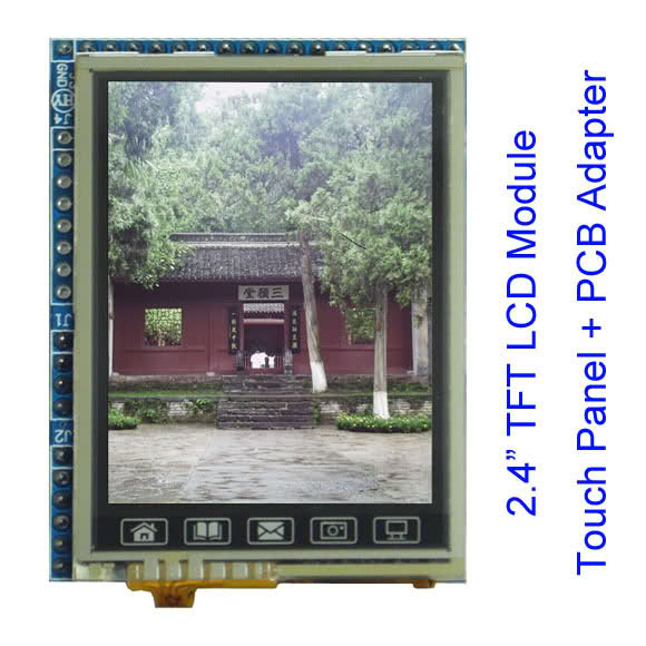

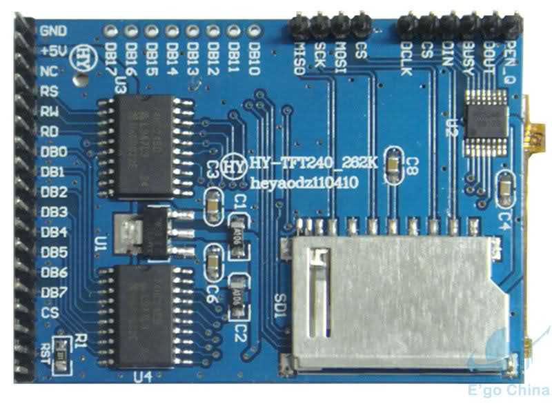

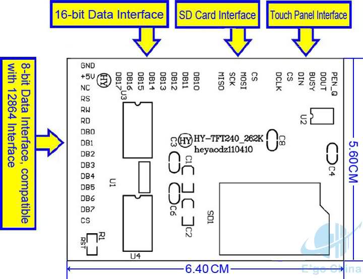

I'll provide information of the LCD here, to what I'll connect my PIC18F4550. Another thing that confuses me in the code is that, data lines of one port, say, PORTD of MCU are connected to the DB0-7 of the LCD, but in the test code, Chinese use DL first, then DH to the same PINs that where load with DL (you can see this in the code provided above, on main file, in data/command functions "write_" around the end of the file).
Please help and give ideas so that it would be possible to go on, thank you in advance!
