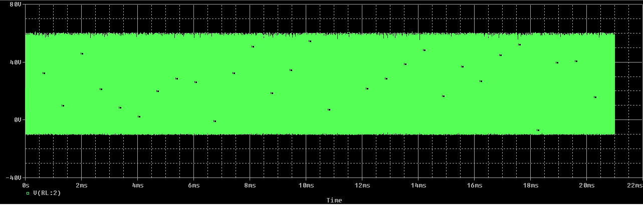

I'm trying to build a Common Base Colpitts Oscillator for a project in my university. I've been failing at this for somewhat over a month now. I've tried various times to build the actual circuit, but the oscilloscope isn't reading anything from my circuit. :(
The only specification is that the peak should be at around 450-550KHz.
I've also tried the circuit in various PSPICE simulations.
I was previously trying a different configuration, but I kept getting an overdamped sinusoid displayed below:
The current schematic I am using is this one:
This is my output:
For some reason that I cannot make sense of, at 21ms the oscillations disappear. I can't seem to understand why, and this is part of the problem.

Damped ringing is a gain problem. You are under unity gain, which is allowing your oscillation to die.
C1 is the feedback path, it is a bit low. You might try increasing it. Or not.
This is not a classic Colpitts design. You might want to start from scratch with a different arrangement. A classic Colpitts uses a split capacitor to invert the signal, which creates the positive feedback when used in conjunction with a inverting amplifier.

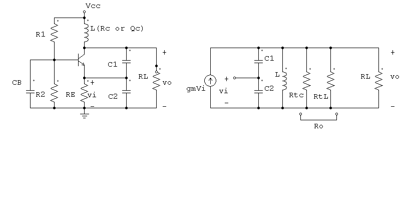

The schematic I was following was this one:
Which I obtained from this website:
https://docs.google.com/viewer?a=v&q=cache:iwb646iuuz4J:venus.ece.ndsu.nodak.edu/~yuvaraja/EE421/E421-N-Colpitts%2520Design1.DOC+common+base+colpitts+oscillator&hl=en&gl=us&pid=bl&srcid=ADGEESiEGhy925ZF-OwUwrpYQV1maRezzB27gOGbrfMVZoHoYw7Hn-aBygLIHTK-EjrkY425P1CM6Jn20tmfvNC66x-_l4wzQxVK1aUbrHkOJ-FT2h-wQwiG3tTptWIe_tsQCyMUnse-&sig=AHIEtbRdYSNN76MMLvwl-Bsx707vBjEYYQ
I've recalculated the values trying to follow all the given equations. I'll organize my work and scan it in a day or two. :)
From my new calculations I obtained
C1 = 9.2725pF
C2 = 328.96pF
L = 10mH
R1 = 2KΩ
R2 = 2KΩ
RL = 1KΩ
RE = 65Ω
CB = 150pF
When simulated on PSPICE I failed to get any oscillations. :(
I'm willing to use a different schematic than this one, maybe there's something inherently wrong with the equations, but I was following it since it was basically a step by step guide type of thing. :)

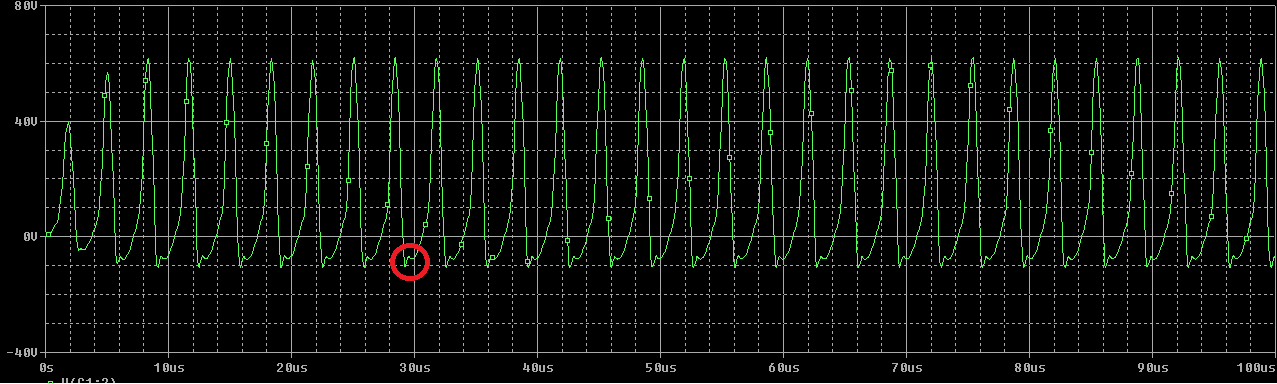

Try zooming in on the mush being shown. You may find a stable sinusoidal signal.
Yes, I'm getting a somewhat stable somewhat sinusoidal looking signal.
I mentioned it to the last person who requested my schematics. I circled in red where I have a bit of a ripple.
The oscillations look a bit triangular, but I'm not sure how much of a problem that'll pose. If the ripple can be fixed, it should be good.
This is what I have now.

As Michael Jackson once said: "This is It."
It seems to be working fine in the simulation, perfectly fine. The experimental isn't as nice. I'm getting a frequency of 56.18MHz when it should be 500KHz. Not entirely sure why. Oh well.
