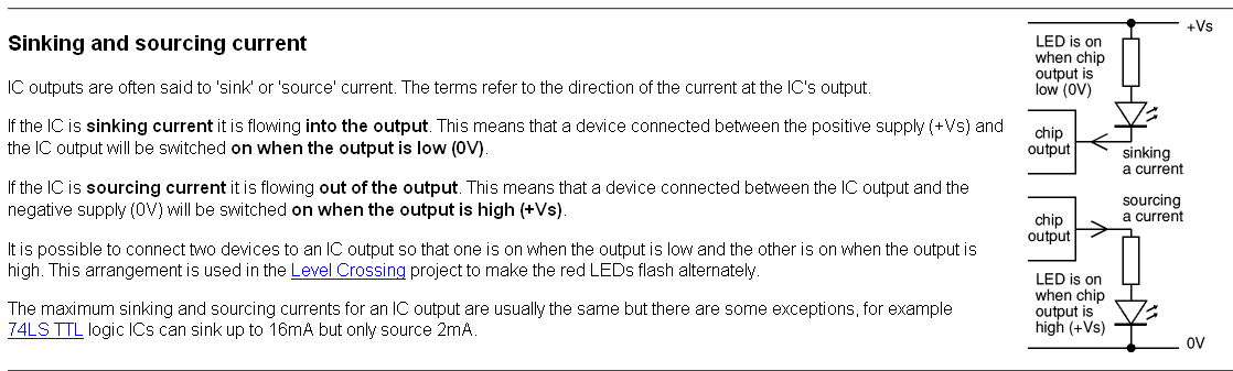

I am using the following circuit to run an LED.
Page 9 Top left diagram
LINK
but the problem is the output voltage on which the LED runs is very low (≈0.4V when supply voltage is 12V. How can i make this LED run brighter i.e increase the output voltage?
Atm the values are -
Supply 12V
Capacitor 330nF
Resistors 1.2KΩ each
