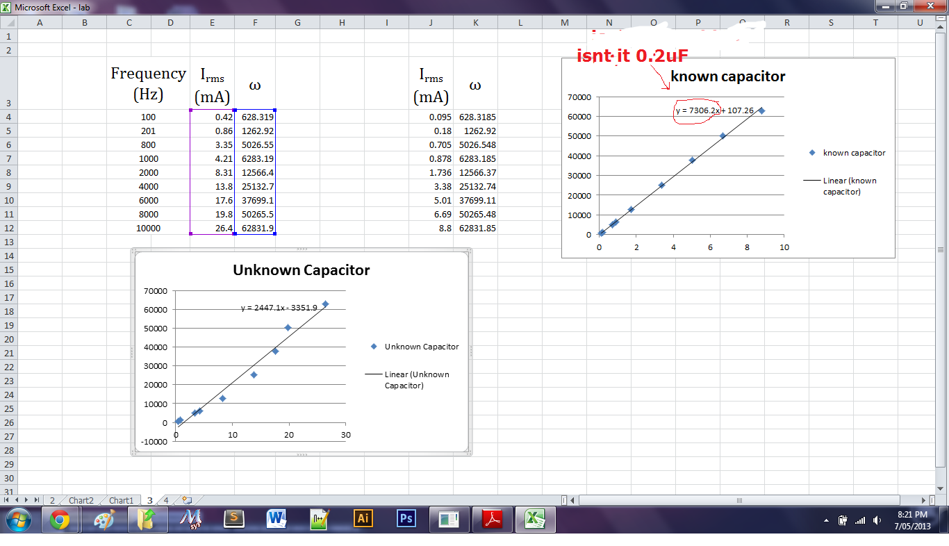

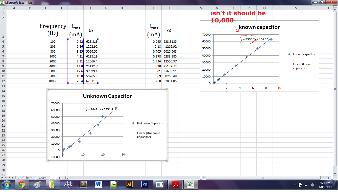

Hi,
This is my data of Irms and angular frequency, and I have to plot the graph and teacher told me that the gradient will be capacitor's capacitance?
i run the experiment with unknown capacitor and sinusoidal voltage across the capacitor is Vpeak = 2V and frequency varies.
then teacher said to plot the graph from following data and he also said that the gradient will be capacitor's capacitance .
He said to prove your method use known capacitor which is 0.2 micro F and we can do the same experiement on this capacitor as well and the gradient of graph will be capacitance of capacitor but i got wrong answer.. so am i doing correctly?
and this is my excel result
