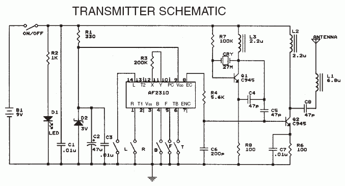

Hi, i disassembled the controller from an old RC car i have, i was a really sad day to me because it was a real nice car. My intentions with this are to make another car from scratch. I do not intend to use the parts from this one! All i want is to understand how it works, but i took a look and a few things caught my attention, first, the levers used to control the car use a parallel plate that interacts with the circuit and i never saw that, maybe it's cuz i am new to electronics. Second, i couldn't find the name of the ic on the board to read a little bit about it, and third, help me understand this. I'll attach some images from the controller:

The operations of the IC will probably remain a mystery, because it is not a generic part with a published datasheet. Instead it is probably a custom part with an "in-house" marking. You could try contacting the company, but they will probably ignore you or treat you like a common pirate out to steal their intellectual property. If you want to build a car from scratch you have a long road ahead of you grasshopper. Start with the basic physics of propulsion and maneuverability. Then study vehicle stability and control. Finally material science and fabrication. You'll get there, but not rapidly.

That appears to be a very old and crude style of controller by modern standards, Unless wanting the experience, it is hardly worth building a TX/RX now when a 6ch 2.4Ghz digital/proportional controller can be had for less than $35.00.

I imagined it was a custom IC.. cuz i couldn't find the datasheet for it. It really intrigued me the way it worked, those silver markings in the circuit and the sliding plates.. any idea of how this works ? I think the right question is: How to make a controller like this nowadays ? With cool levers like that... maybe that will give me the answer i was looking for.

It seems as though they used the very old bangR-off-bangL technology with maybe a slight refinement to give a couple of positions, the modern controllers use variable pots on the joysticks.
Probabally a 72Mhz Txmr.

The operations of the IC will probably remain a mystery, because it is not a generic part with a published datasheet. Instead it is probably a custom part with an "in-house" marking. .
The GM prefix is a commonly used one by a mainstream manufacturer - Unfortunately it escapes me at the moment, but if I were to hazard a guess I'd say Goldstar (LG). When I serviced PC monitors for a living, I used to see quite a few GM prefix chips, and the printed style looks about right too.
At least try a search before writing it off as a house coded custom part.

Sometimes you won't find it unless you include the suffix - sometimes you won't find it if you do include the sufix! It often takes a bit of trial and error.
If that doesn't get you anywhere and you think you know who the manufacturer is, try looking up their analogue range and see if you can find any cross reference lists. Often another manufacturer does the same chip with the same base number, but their own prefix.
On very rare occasions, Googling just the base number has scored a hit.

It somehow doesn't have that "look and feel" of a house coded number - but it could be discontinued.
The prefix looks like its an LG part number, they can be tricky because they sometimes use a different base number to other manufacturers for electrically identical parts.
You have to do a bit of detective work, and keep at it if the info is that important to you - once I found a timer chip in a scrap toaster that I thought might be house coded, but I did a search anyway - not sure exactly how, but I found a Russian chip with Cyrillic part number that did the same thing - when I searched for that, a datasheet for the chip I was originally looking for suddenly popped up.
