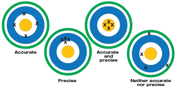

https://www.mccdaq.com/TechTips/TechTip-1.aspx
To be useful, a test meter must be both accurate and precise. Even in circuits built from high tolerance but stable components we don't expect actual circuit operational parameters to dynamically vary by the component tolerance. Most complex process systems are dialed in (adjusted) to a set standard and checked for deviation from that standard. So having a measurement system at least 10X better than the deviation tolerance is a common standard for meters so you can detect and correct before limits are hit.

I like the diagrams. The terms accuracy and precision often get used as though they are the same thing
