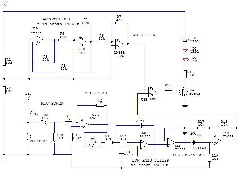

http://img.photobucket.com/albums/v347/jurgamund/circuit.jpg
This is my current schematic. As I'm typing this I realize I forgot to add in two capacitors that go from +12V to ground. One is electrolytic, 100uF and the other is non-polar, 10n. I'm not even sure what these do, but they were included in the schematic I based the sawtooth circuit off of.
The issues I still have:
1. Any way to smooth the rectified audio wave?
2. It seems like there is a capacitor somewhere that is firing when it shouldn't be. The LEDs will occasionally blink at full strength briefly for no reason after a few hard bass hits. Any idea where this might be originating from?
3. The final design is not going to light blue LEDS like this one, but about 80 red ones. I know how to wire up LEDs just fine, I've done this many before, but I don't think my transistor will handle that too well, as about 320 mA should be flowing through it. Any recommendations on replacements?
4. In case you can't tell, I don't really know what I'm doing all that well. I kind of took a jigsaw approach to this, and I'm kind of surprised I have it working as well as it does. If you see anything in my circuit that I'm doing terribly wrong, please tell me :rolleyes:
Thank you

1. Try a 0.68uF cap from U4 o/p to ground. (0.68uF might be too big, but its a start.)
2. Golly. No clue here.
3. I humbly suggest ye olde 2N2222a
4. You might have a look at the relevant sections of http://www.allaboutcircuits.com/ to better understand the building-blocks you are using. Fair warning: the more you learn about your components and your basic circuits, the more fun ideas you will have.

Here's an idea I had... I think the whole thing would look better if the leds were by default glowing a tiny bit, so the that when a big bass hit occurs it isn't so harsh on the eyes. The only way I can think of to do this is to have the audio wave automatically start out at a volt or so. I tried divided the voltage and sending about 1 volt into the plus input of U3a, and then I tried the same thing at the U2B plus input along with the audio signal, but neither of these things worked. Is there a way to do this?

For the mic circuit AGC, I would use the Analog Devices SSM2166 (see attached circuit 1, the mic attaches between R11 and GND). If you pull pin-2 (VGA) low thru ~200 ohms with a properly connected xstr or FET, you can mute/unmute the AGC amp with a control signal (otherwise just set VGA per schematic).
I think you may be better served by the second circuit shown in the attached for buffer/rectifier/filter. On AGC output, change C35 from 0.47uF to 0.22uF. You can add a 100K to 1Meg in series with the input U1 pin-10, after C35, to reduce sensitivity (if need be).
This is a single-ended application where +VAREF is equal to Vcc/2 (third circuit) and will be okay with your +12V (but, you will need to regulate your +12V down to +5V for the AGC amp, a 78L05 or similar should work fine).
So ...you would simply feed circuit 1 into circuit 2, which would then connect into U2B(+) on your circuit, and replace what you presently have going into U2B(+).

Here's an idea I had... I think the whole thing would look better if the leds were by default glowing a tiny bit, so the that when a big bass hit occurs it isn't so harsh on the eyes. The only way I can think of to do this is to have the audio wave automatically start out at a volt or so. ...
Here is a possible solution for biasing your LEDs on slightly. You will need to experiment with the value of resistance to obtain the level of brightness that suits your eye.
