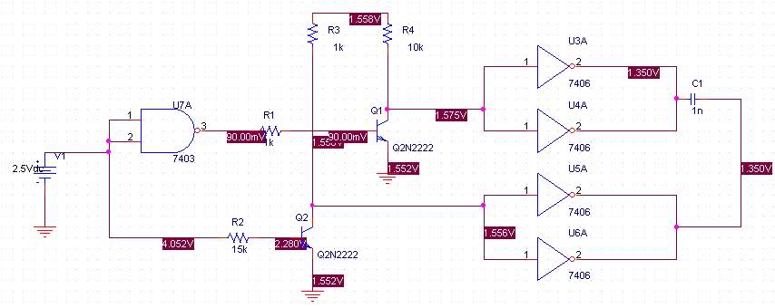

Hi,
I'm just asking for some assistance since I'm not sure of amplifiers much.
My question is that I've programmed my PIC micro that is emitting a Square wave 2.5V peak to peak to a transducer that can handle up to 140V, the thing is that I need to amplify this signal to at least 10 times so it's 25V peak to peak if possible at the output?? A overall gain of 10 times or higher.
I'm stuck between choosing between a opamp? voltage comparator? to amplify the voltage? I'm good in programming micros and electric circuits but when it comes to electronics part ive been somewhat confused in the amplifiers area. Also I checked my uni books however it explains only theory and there's no mention of any practical application (there's only info on sine waves, not square waves) that meets my need.
I have a 9V rail as well if need be. So any push in the right direction would be loved! thanks...

Hello,
Can the transducer also a squarewave signal?
What power is expected at the transducer?
What is the impedance of the transducer?
What will be the frequency range?
Greetings,
Bertus

* Yes the transducer can take in square waves
* yes the transducer can operate > 20KHz. I'll be using it at around 38KHz
I'm not worried about the impedance of the transducer, I just would like to know what type of circuit I could use to get that 10 gain output (25v output from a 2.5v square wave signal input coming from the micro)??
thanks
edit: its ultrasonic transducer btw

A few suggestions:
1. Your model of ultrasonic transducer is very frequency selective and should be driven with a signal as close to 40KHz(the spec) as possible to get the highest output. Alternatively, you can monitor the receiver signal and adjust the 40KHz frequency up/down a bit to get the maximum response.
2. Using a signal generator, you can feed a 40KHz voltage adjustable up to 20V pk-pk into the transducer. You can then monitor the receiver response to find out if higher voltage drive really give you the increased distance, before you actually build the amplifier.
3. Output stage suggested by bertus above is the best for your 9V battery as it puts out about ~17V or more pk-pk to the transducer. However, you'll need to add an additional simple interface between the 0-5V PIC output and that amplifier stage.

Hello,
Did you put an 5 Vtt (2.5 Vdc) squarewave at the input?
The two outputs are out of phase, this will double the output voltage.
The 7406 is for 5 Volts only.
The 4069 as used in the schematic I gave you can be used upto 12 Volts.
Greetings,
Bertus

sarahtelayrii, please note comments by bertus.
Here is one done in LTSpice, the "free to use" Spice simulator.
Note: The CD40106B is supplied by 9V in order to generate a 18V Pk-Pk output. As such a NPN transistor is required to interface with the PIC output which is 0~5V.

I must admit that is a brief data sheet and it doesn't mention impedance at all. Now I understand why you weren't concerned about it. It looks like power transfer is not an issue here.
Here's a schematic that includes a simple single stage BJT (Q3) that will deliver 60V square waves to a high Z transducer. Since the transducer is resonant it will filter the square wave (some what) when connected to it.
In the event that your transducer doesn't like square waves, I've included a resonant 40KHz JFET amplifier. The outputs from the two amps can be seen in the graph. You can see clearly how the 5V square wave input is converted to a sine wave (top plot) on the output of the resonant amp.
The circuit in the box is just the test source to simulate the ouput of your Pic.

sarahtelayrii
Joined May 2, 2009
12
Hi,
I talked with a technician I know at my university today, and he suggested a way to drive 9V up to 18V, with the input being a 0 to +5V square wave.
It's basically like this:
http://instruct1.cit.cornell.edu/co...49_mar97/jjl49_mar97/index_files/image006.jpg
However instead of just being the one LM311, there is a 2nd LM311 just below it but that is inverted with - top and + being on bottom. This too connected to 9V and with a 330ohm resistor. I've got the parts and Ill try it out now. I'll post the complete schematic later on.
However if I measure the output pin of the square wave signal coming from the micro, for the value of the voltage it's at 2.5V, though there's a square wave on the oscilloscope going from -2.5 to 2.5V from a 5V regulator source and not from 0V to +5V square wave. I asked him about this and he said most likely the oscilloscope was on ac coupling and not dc hence it not being 0 to +5, but I'll see what the result would be once everything connected via a multimeter.
