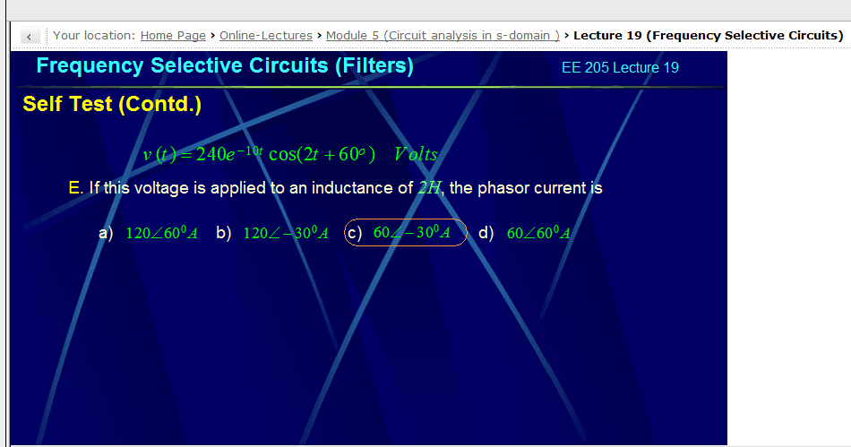

I had a problem with a problem > how come
here it's
I think his answer is wrong !
because s = -10 + j2
and when you calculate I = V/Z
you will never get a degree of - 30 !
I hope someone corrects me if im wrong
