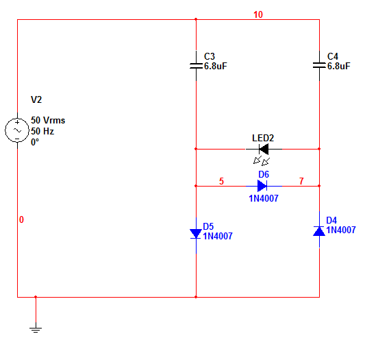

    Hello, I bought some bright powerful LED's peak-rated at 2W each and I want to run them off a safe 50 VAC power supply. I decided against regulator circuits because of the cost and/or complexity (if I were to build one) so I thought of another design using caps for limiting current but yet using both halves of the wave.
    Here's the basic circuit:
    [​IMG]
    As safety precautions I plan to add a fuse before the circuit and MOhm-rated resistors in parallel with caps so there's no residual voltage. The anti-parallel diode is there just in case any reverse voltage goes over
    I haven't built it yet (it works in simulations) and I would be happy to receive criticism and warnings before I do build it and it melts my face.

    You should be concerned about the peak current at turn-on. In some tests on some 240VAC AC powered LED luminaires, failure rates were very high when a series current limiting resistor was bypassed. Ten ohms gets you a safe peak current of 7.5 amps.
    Another, more common topology for the capacitor limited power supply is to put a capacitor and series resistor in series with the AC source and then drive the AC input of a full wave bridge with that. The output of the full wave bridge is...full wave! Remember the bleeder.

    Your schematic makes my eyes cross...and besides, I think you have parts that aren't doing anything helpful. Try this. Add a surge limiter if you want.

    #12 adds another diode I do not see the need for. I also do not see the need for your C4, just one series cap should suffice.

    OP was careful to say, "safe 50V AC supply".
    ps, the 5th diode is an LED. This circuit will not light up an LED if you do not attach one.

    Ah, of course, I had thought about using a full-wave rectifier with 4 diodes but decided that it wouldn't work as I imagined the cap to be in series with the LED. It never occured to me that I could put it before the rectifier, thanks guys! Diodes are cheaper than caps anyway.
