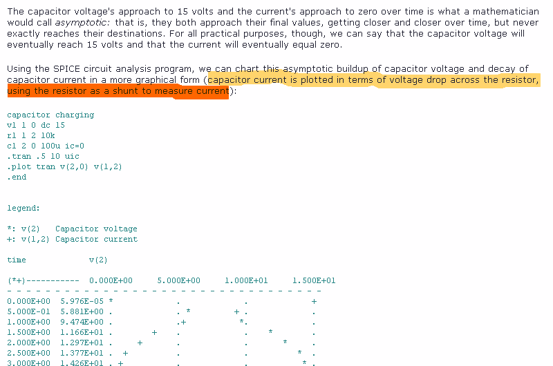

Yesterday I've finished to read the DC-section of the theory book about electricity (in some places it was only a bit boring, but these explanation about thermocouples, about superconductivity, also about steering system and cart moving (who readed it knows about what I'm talking about ) — are very exciting and non-standart, giving awesome understanding), but I need a small explanation please.
Yeah, it may be a bit weird question, but: does that shunt resistor in-builded inside the SPICE programm (in transient-analysis function), or what? Where is it? I can't see it in netlist.
Link to the online version of the book: http://www.vias.org/feee/time_03.html
