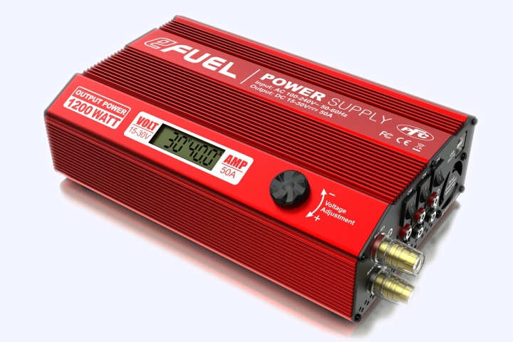

What about this?
The eFuel 30A Power Supply (£80.00)
Your eFUEL switching DC Power Supply is designed to use household AC power source to power equipments that required DC power. The eFUEL converts standard household power 100-240V AC to 12-18V DC power and can supply up to 30 amperes of continuous power.
FEATURES
  • Two DC power outputs, up to 30a
  • Output voltage adjustable 12-18V
  • Large LCD indicates voltage and current amperes output
  • Two USB ports, 5 volts, 1000mA
  • Smart cooling fan
  • Over temperature protection
  • Overload protection
  • Short circuit protection
Or, better still this:
eFuel 1200W (15-30v) 50a Power Supply
FEATURES
  • 1 x DC power output, up to 50a
  • 3 x 10a Outputs (On/Off)
    Output voltage adjustable 15-30V
  • Large LCD Display
  • Two USB ports, 5 volts, 2100mA
  • Smart cooling fan
  • Over current protection
  • over voltage protection
  • overload protection
  • Over temperature protection.
    Short-circuit protection (on output)
There is also a 'eFuel 1200W (15-24v) 60a Power Supply', but I can't find the specs on the website.

Looks good! I suggest you use 2 x "ANDERSON" DC plugs instead of the one illustrated in the video. Available from dealers in camping equipment or electrical wholesalers. Good connection and will allow you to at least use wire that is capable of carrying the required amps. The guy in the video did not show what happens when you do some real work with your cordless tools using that thin wire and small DC plug on the end!
Ripperoo
Joined May 23, 2014
11
If you mean the ones below, then I did actually consider those.
But I think I will end up using industrial 24v 16a connectors (violet) that we have in the UK (not sure about elsewhere) as shown below:
I would probably opt for the 3 pin version though, but couldn't find a decent photo.
I'll also be using much thicker cable between the power supply to the 'converted battery @ 3x1.0mm² x 3metres long (similar to the cable on your averge IEC TV power cable)
That way, if anyone was to 'accidentally' plug in a device with a compatible connector, the voltage would be less than the equipment plugged in.
I hope that makes sense! LOL
