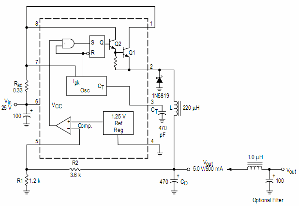

This project converts 12v DC to a regulated 5v DC at up to 1.8 amps, suitable for driving a tablet computer from a 12v car battery in a power blackout etc.
The circuit for this buck converter is nothing original, basically it is the circuit from the 34063 IC datasheet, and all I did was to use an external PFET instead of the external PNP transistor shown in the datasheet. The external PFET allows currents up to a few amps at good efficiency, however I have used hard current limiting at 1.8A for safety and good performance in this prototype.

34063 SMPS IC.
The 34063 IC does all the clever stuff, mainly it regulates voltage at 1.25v on VFB pin5. Because of the 6k8:2k2 voltage divider on the output, this gives very close to 5v, I actually saw about 5.01v-4.99v Vout in testing, very nice.

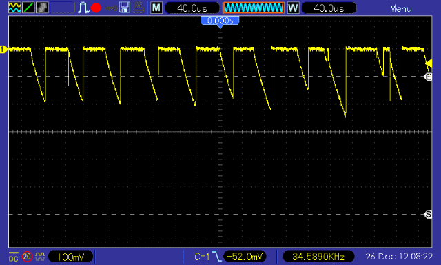

Max current limit resistor.
The resistor between Vin and pin7 sets the max inductor current limiting, this was set by me to roughly 0.18 ohms to give 1.8A current limiting. (Imax = 0.32v / R = 0.32v/0.18 = 1.78A). The current limit is best at slightly above the max required current. This gives better safety and also helps stabilise oscillation.

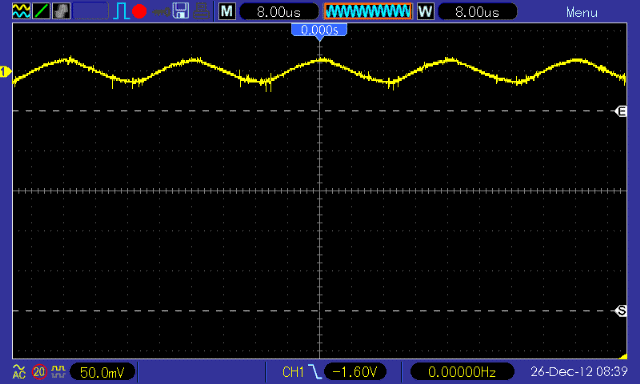

Caps etc.
CT used the datasheet value of 1nF. That gave oscillator value of 26.2kHz measured on pin3 (with no load), however the whole circuit usually operated at 29-33kHz because of the way the regulation works in the IC. The filter caps; 680uF on the input and 1000uF on the output were chosen to be "good enough". Output ripple was approx 25-30mV which is fine.

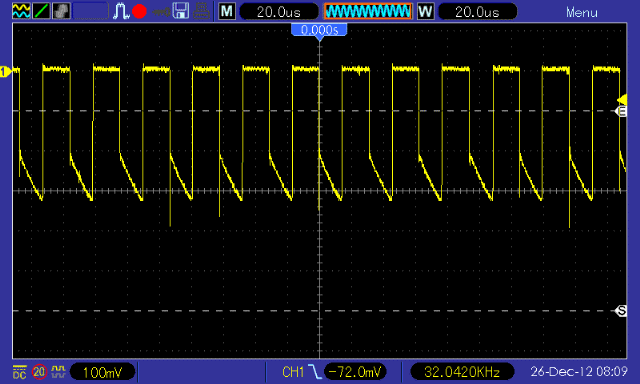

Scope current L1 inductor (on period) at 5v 1.5 amps.
Above is the on period current through the PFET and L1 inductor. As it is a PFET this is inverted so the pointy bit at the bottom is the max current, the top is zero current. At 1.5A and 32kHz the SMPS is very stable, as switching period is reduced becuase the peaks just hit the 0.32v max current limit set by my choice of 0.18 ohm resistor. (However voltage regulation is still the main regulation).
Duty cycle is about 44%, and current ripple in the inductor is nice and low with inductor current averaging 1.5A (ripple of 0.56A, between 1.22A and 1.78A). The noise spikes I suspect are from from my messy PCB with power and load wires everywhere and 'scope leads laying around next to the PCB and wiring.

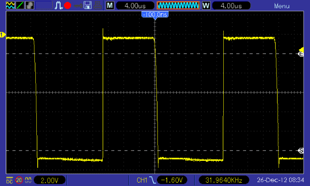

Schematic and operation.
Sorry for the hand-drawn schematic! As you can see the circuit is minimum parts. It uses just two resitors to drive the PFET from the IC (same as the datasheet), this is not ideal but was done to test the concept and see if a PFET can be driven as easily as the PNP transistor normally is. PFET turnon is good at 0.07uS, but turnoff is not great taking 0.8uS. This costs about 1-2% efficiency. The 560 ohm resistor could be reduced to speed up the turnoff, but this would increase losses in that resistor so it is a tradeoff.
