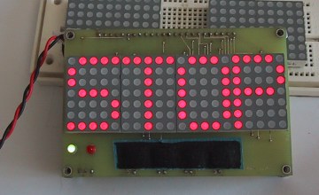

25x6 pixels is only 150 LEDs. I just did that with 144 LEDs and a pic 16F877.
http://www.youtube.com/watch?v=Q_pF8WSTVGU
http://www.youtube.com/watch?v=ICsi2mhrH94
The power LED at the bottom is another output that could have easily been
used for another row of 18, and there are still IO pins to spare for the joystick.
To answer your question there are port expanders from Dallas/Maxim that ( I believe) do that.
Also a shift register can translate a serial input to 8 LEDs.
An interupt driven microcontroller program (running on multiple microcontrollers) could be used.
I plan on making three of these units with routines to make them cooperate as a large 6 digit clock.
Art.

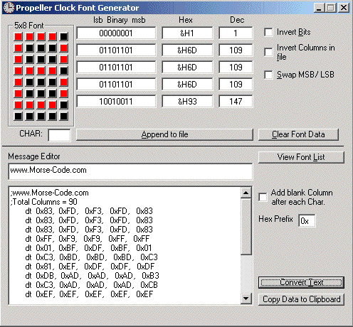

Yeah, built in fonts are very handy, there were plenty of times where I had to create my own fonts, but for these LED based message displays I had created an "LED Font Creator" to help in designing fonts and other graphics for POV displays....
the app can be downloaded here >> http://www.morse-code.com/id45.htm
