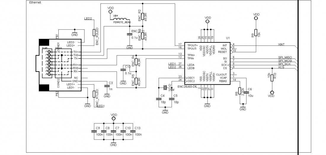

I mean I saw a couple circuits on the net (including one found here: https://electronics.stackexchange.com/questions/51648/enc28j60-no-communication-over-ethernet) which didn't use a transformer at all but instead a direct connection. I attached the schematic here:
Is there another way I can stop the EMI? Could capacitor coupling of the signals help instead of transformer coupling? I don't want to buy expensive new jacks just to get a transformer when I have piles of regular jacks, capacitors and inductors already at home.

Since this is for a personal project, I honestly don't care if the speed is super low to todays standards (10Mbps). I just want to create an ethernet link between standard ENC28J60 part and a PC without having to buy fancy jacks. As I said in my earlier post. I have all the other parts (including basic RJ45 jack). I just need the transformer (or a way I can build a circuit that provides equivalent coupling with sufficient protection).

Ok I'll use that schematic but what resistor values do I use? I mean they're suggesting 33nF caps (I have 47nF ceramic) and theres some cap values unmarked. Could I still use 49ohm resistors and 100nF for the remaining caps?
