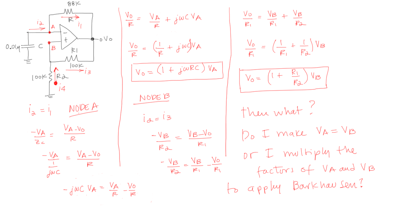

How can I apply the Barkhausen criterion in order to tell if the following square wave generator(relaxation multivibrator) do oscillates?

Yes, I agree with you in that the Barkhausen criterion would apply only before startup but how? We need to relate the VR1 and Vc (voltage at R1 and the voltage of the capacitor, respectively) but how and in what way and why?

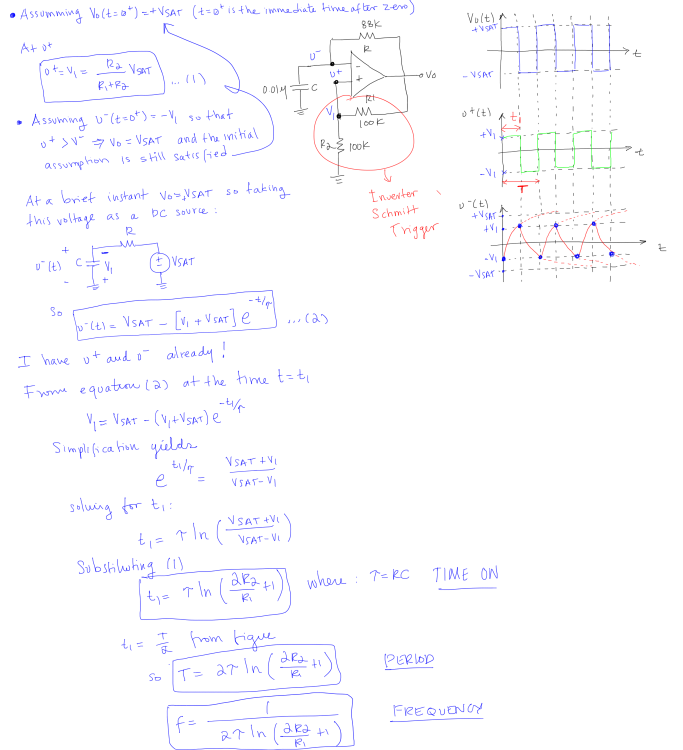

First, I do understand the circuit as shown in the following mathematical developement, which proves I'm not being lazy and just waiting for someone's answer without "showing some work/thinking" as you state it. Also you are implying you already have the answer to this problem, just that you are reluctant to provide it because I'm not "showing some working/thinking" and you even provide a clue onto how to proceed to the solution, this in part gives me some hope that at least it is posible to apply the Barkhausen criterion to this relaxation oscillator and I agree with that since you are employing part of your time helping for free and because you want to help and you don't want to give it to lazy people whom you think doesn't deserve it.
So as for the understanding of the circuit:
As you see in the analysis I assume a certain steady-state starting point conditions within a cycle, and from there proceed to develop further taking care the previous assumptions are still valid. From my understanding of the Barkhausen criterion this is another way to state it, that is, by making this initial assumptions (even when I've already assumed a steady state condition)

It's interesting that one might consider applying Barkhausen to determine oscillating frequency in a linear oscillator model. As you show in your analysis one must consider the non-linear operating model to find the relaxation frequency for this circuit. So Barkhausen is of no use on that score.
As I noted in an earlier post a typical method of linear analysis involves finding the open loop transfer function. To do this one might break the negative feedback path at some convenient point - say at the amplifier output. The input for the purposes of finding the open loop TF then becomes the break point terminal so formed.
Also one would treat the amplifier as a finite gain of value A which you can then subsequently consider as tending to an infinite value if that is useful. The "problem" arises in this case with the fractional frequency independent positive feedback.
What will all this reveal in the end? Certainly not the oscillation frequency. At best one would find the necessary amplifier gain to ensure the output will switch between its limiting states.

I'm interested mainly about a) as for c) it is just a matter to make R1 = 0.86R2 so that the logarithm becomes 1 and you get a linear relationship (triangular wave) but for this I don't know what and how it will affect what must be obtained from a)

Did you read the link to the Pearson-Anson effect? Did you see where it says " As the neon lamp exhibits negative differential resistance in the A–B part of its I–V curve (see the figure on the right), if it is driven by a voltage source (the charged capacitor here), it behaves as a switching element with hysteresis (a sort of Schmitt trigger)." That seems like a condition for oscillation.
Well, now that leads to the question:
Why I couldn't apply Barkhausen for this SPECIFIC circuit? Is it because (to put it simple) there is no lag/lead circuit, that is, RC circuit, in the positive feedback as in a wien bridge oscillator?
See this reference: http://en.wikipedia.org/wiki/Electronic_oscillator
The Barkhausen criterion applies to linear oscillators. A relaxation oscillator is very non-linear, so I don't think Barkhausen is relevant.
