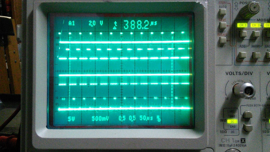

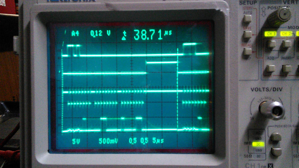

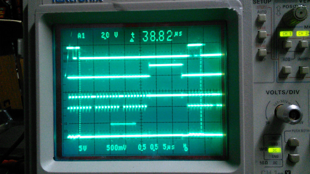

13,306
I've added the code in my kernel protocol driver to speed up the sample rate to 1024 samples in a chunk at the SPI device kernel level instead of single requests. This has the effect of reducing the scope software user-mode CPU use to less than 50% while speeding the max possible scope sample rate to at least 10k per second. The kernel thread CPU use has increased with the lack of DMA but that's ok with 4 cores.
With full DMA the speed should be at least 20k and usable for lo-fi audio waveforms.
The RPi SPI hardware interface is the current bottleneck but good people are working on it.
https://github.com/msperl/spi-bcm2835/wiki
https://www.kernel.org/doc/Documentation/spi/spi-summary
The Linux SPI system uses a work and messages queueing mechanism that while good is not real-time, especially at the user level.

This is pretty close to max with what you can get with the current RPi2 4.0.y driver via SPI with a 12bit ADC/DAC system on the Gertboard. (1Mhz ADC & 8Mhz DAC clocks)
Two analog 8bit (from a simple 256 entry table) signals generated on the RPi2 using a separate program (bmc) with the Comedilib programming interface via the two AO MCP4822 DAC channels looped back into the two AI MCP3202 ADC channels with Xoscope (via X on another machine) using Comedi as the data source at 10KS/s with two channels per scan. The driver is working in a unblocked mode here so long term timing is affected but in blocked mode for AI sampling it has the SPI bus for 1000 sample blocks in a Kthread at a time so timing is much better at the expense of other SPI users like AO.

Timing stability from the new spi-2835 RPi driver, still no DMA but it's much better.
Top to bottom (MCP3202/channel 0 then 1) with delay_usecs working great: data in(trigger), chip select, clock (1mhz), data out
Top to bottom (MCP3202/channel 0 then 1) with delay_usecs: data in, chip select(trigger), clock (1mhz), data out
