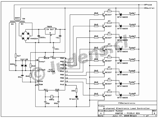

VoodooMojo Joined Nov 28, 2009 505 Feb 26, 2011 #3 here's one using the 16F628 and a link to the author/software code: http://ludens.cl/Electron/picelc/picelc.html Attachments pic16f648 datasheet.pdf 2.6 MB Views: 29
